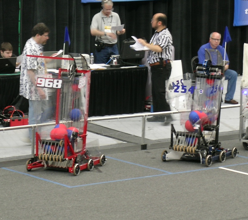

WCD was pioneered by a few teams in the early 2000s (254 and 60 come to mind) and it was revolutionary at the time. The Am14u5 drivetrain is similar to WCD but doesn’t allow quite as easy access to the wheels.
Here is a thread about WCD: West Coast Drive, WCD - #2 by CIM
Here is the best picture I can find of old school WCD.

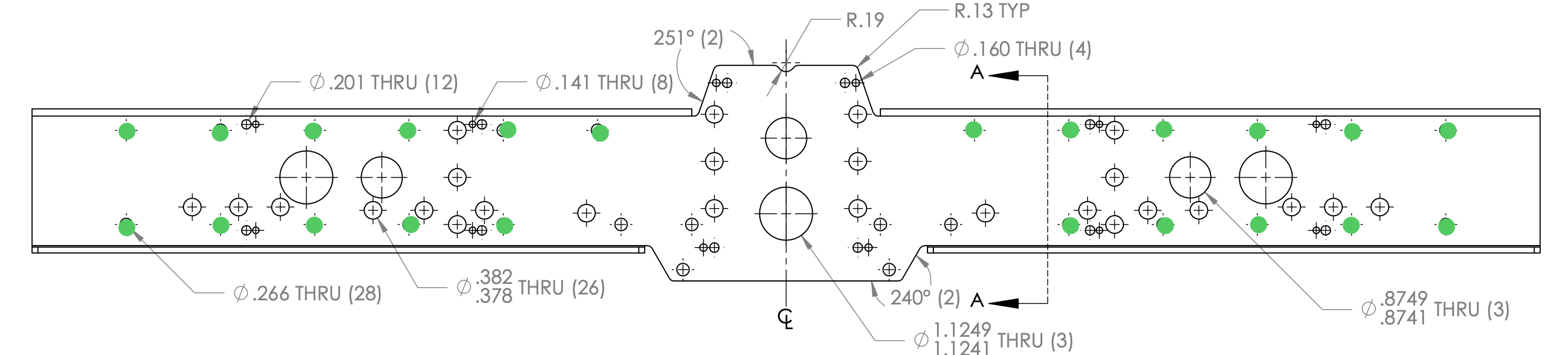

  3. Mounting stuff. The 14U does nerf your options a touch, but it’s manageable. I think a lot of people get distracted by the flange on the top of the inner plate and miss the 2" hole spacing on the vertical face (I’ve highlighted the holes in green). Whether using a COTS gusset (perhaps while stocking up on gear ratio options so you can set your speed quickly) or simply designing a custom plate to use the holes, you can get a lot done.
