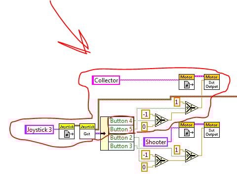

I’ve coded our collection motor to intake a ball (set the ball collection motor to -1) when button 2 is pressed and held down. The ball is spit out (collection motor to 1) when button 3 is pressed and held down. This might be better for your application.

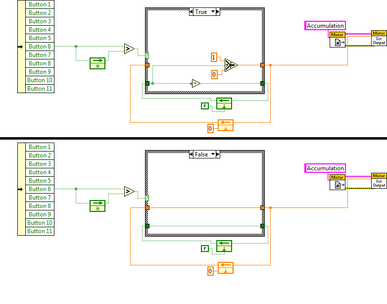

The problem is that you are not constantly feeding the motor with a value. For safety purposes, motors are not allowed to continue their set value unless it is fed a value every so many milliseconds (I think it’s like every 100ms). If you look at the given autonomous code, you’ll see that they use a while loop instead of the simpler sequence structure. This is why this is done.
You can simply add another feedback node, with the motor control value in it, then add the motor to the outside of the case structure, as shown in the picture attached.
Here’s how I would do it, because case structures clutter up the work area, plus it hides half of the code that can execute.

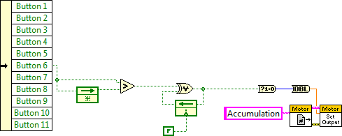

Ignore my shoddy explanation, here’s a picture of the code I’m trying to describe.
The way his code is written is like a pushbutton switch. You press it once, and the motor turns on, you press it again, and the motor turns off. He has the right logic. Your code will work, but it requires an extra button, and it requires the driver to hold the button down to keep the motors running.
Cool, that’s news to me! So his accumulation code will work perfectly fine as is.
