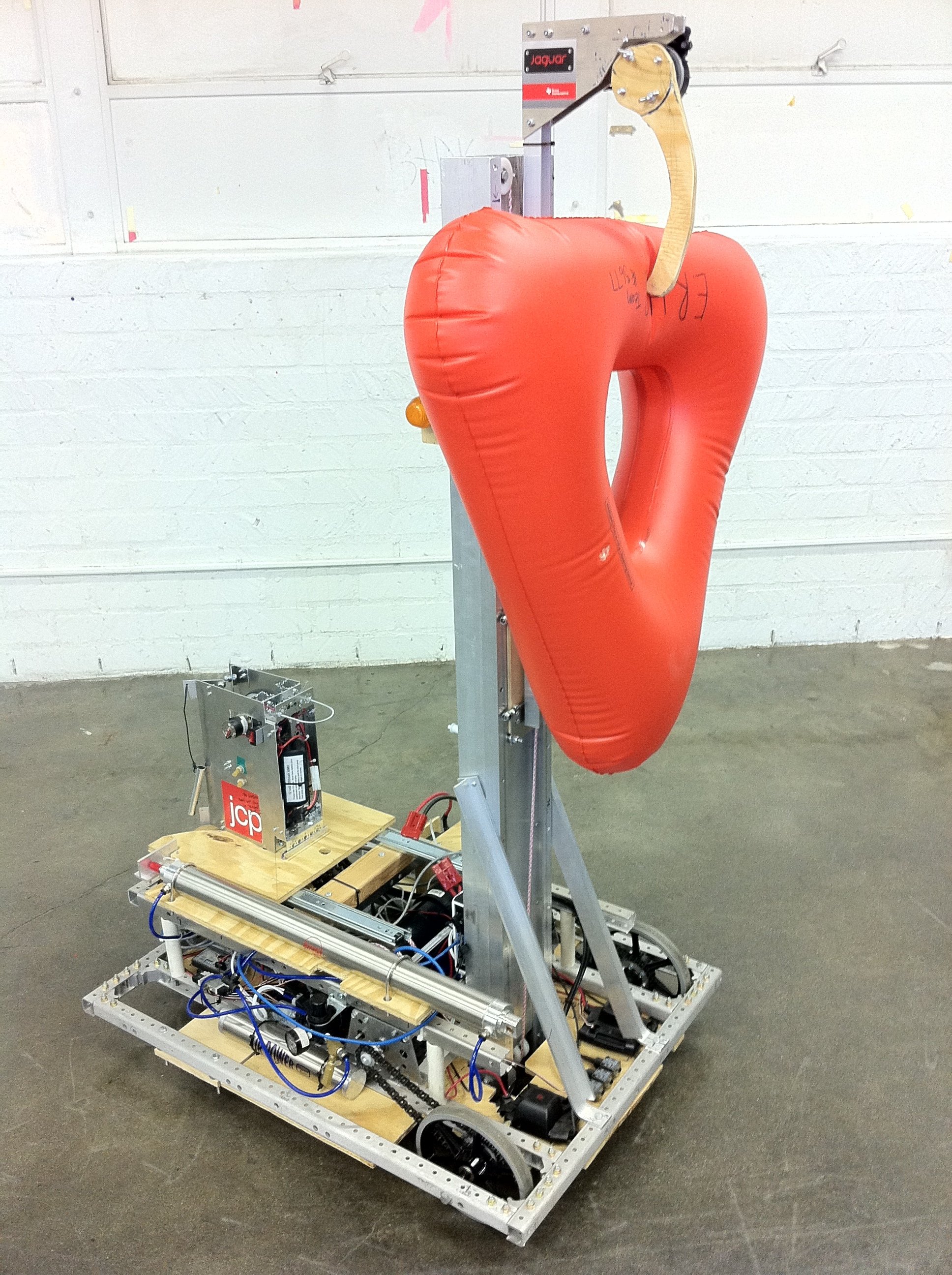

1522 used a ~4’ stroke cylinder in 2011. It’s tough to see in this picture but it’s all I can find from back then. The cylinder runs from the bottom of the robot up to the top of that mast. It worked well but there was a lot of pretty rigid framework around it and almost no defense was played on it while it was extended (I don’t think it was legal to defend in the scoring area that year). ZnkVPjF_d

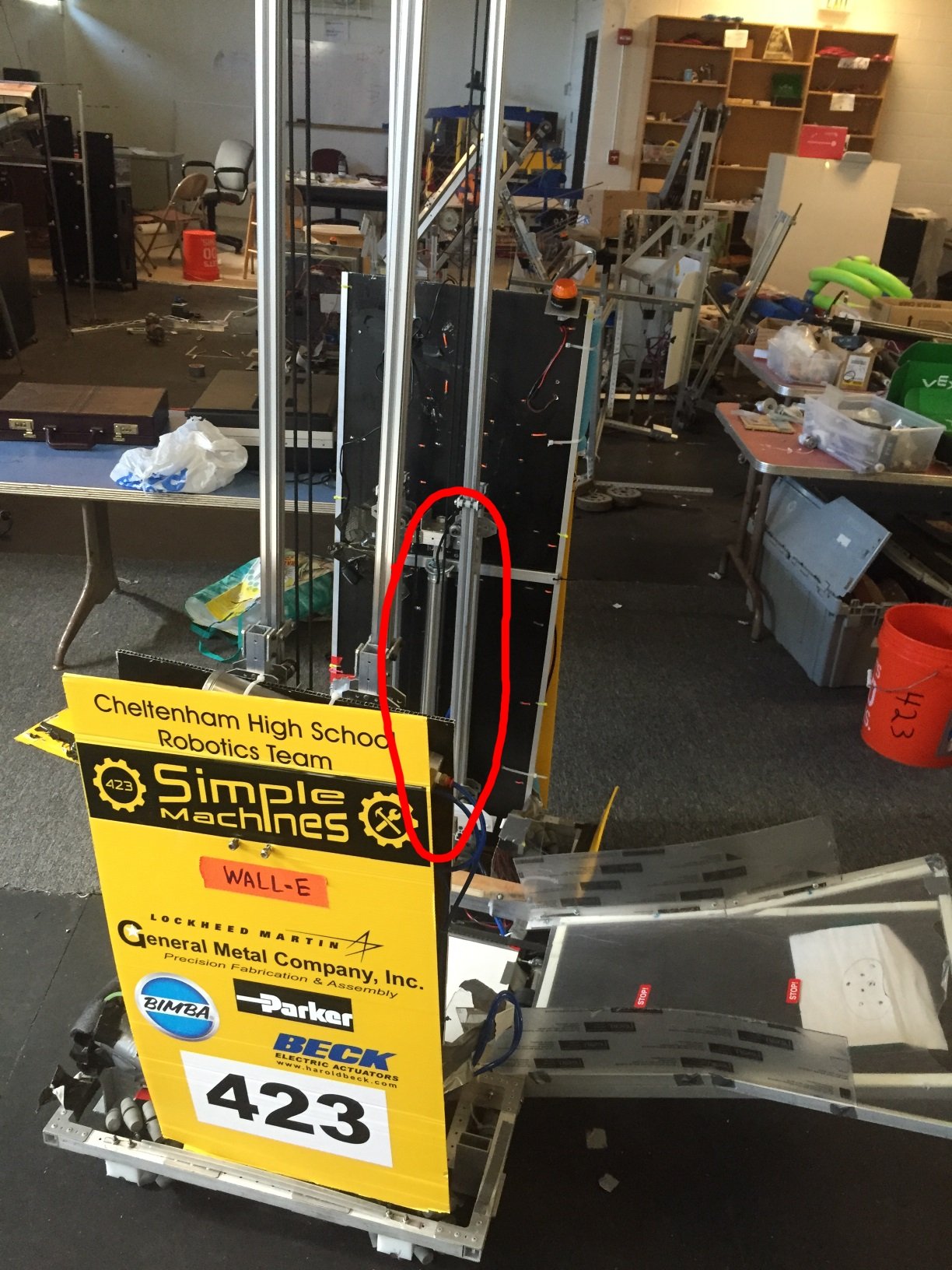

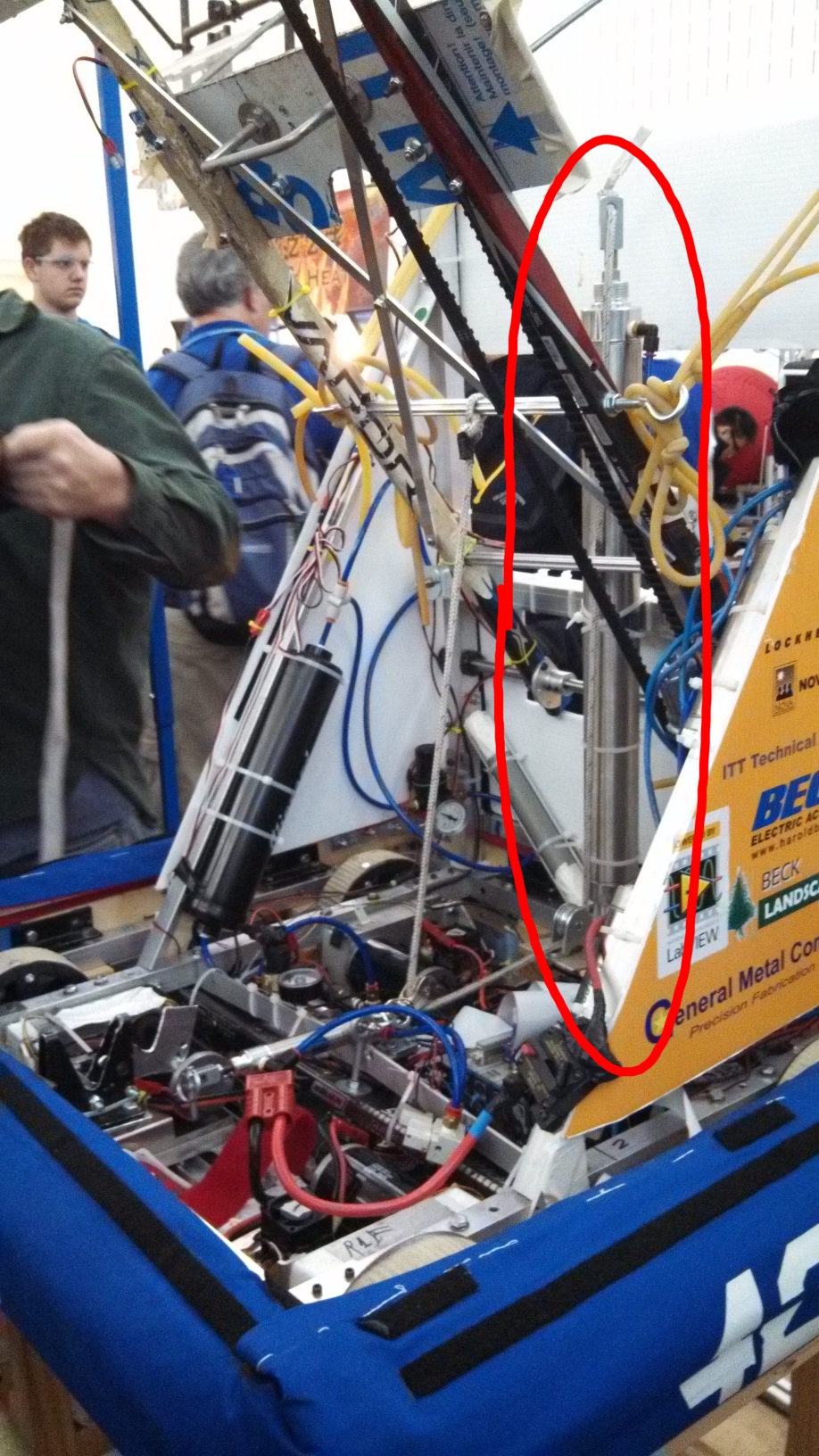

423 in 2015 used 2x ~30" stroke, 1.5" diam cylinder* for our elevator. They worked very consistently and gave the team arguably its best season. The major downside was how slow they were. If we had known a bit more about pneumatics at the time, we certainly could have sped them up (separate solenoids for each cylinder, move an air tank right next to the piston, remove excess tubing, etc) and been even better.
In 2014 we also used a ~30" stroke, 2" diam cylinder to pull back our elevator. Despite the rest of the robot not working well, the elevator pull-back and latch mechanism never failed.
