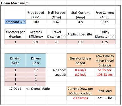

393 motors were legal at one point, right?
Seems reasonable to me
Edit: Changed from a 100% troll post to only a 75% troll
This is a great application for the mechanism calculator in my design spreadsheet. You can enter the load, drum radius, and a defining characteristic (e.g. desired linear speed, current draw, stall voltage) and experiment with different types/numbers of motors. It will tell you the other characteristics that you don’t input: proper gear ratio, current draw, stall voltage, and a number of others.
