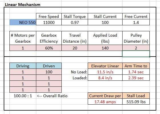

Am I wrong in my thinking? What is your target for climbing speed and distance? Any motor can climb with an appropriate ratio.
I speculated that with a swinging hanger, Alliances will not want severely fast climbing for fear of damaging another member.
We targeted worst case about 20” in less than 3 second. Only a few inches should be under the full load. If my numbers are correct, the NEO550 @100:1 wt 2"Dia. meets the specs, but I can’t believe it. And as other mentioned, my biggest fear is the 10:1 stages of the Versa gearbox.
You’re right that “any motor can climb with an appropriate ratio”, it’s just a matter of determining how fast you want to do it. I think your calculation there looks fine for a sub 3 second climb, but as you mentioned as well as others above, it can by risky to do this with a VP gearbox. If you built a custom gearbox for this application it could very well work though!
