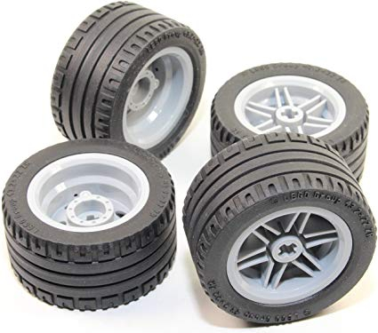

Once did that with a Lego for fun to see what would happen. I stuck one of the flat tire hub tires (see below) on a 6000rpm (I think) motor. The tire itself expanded to about double it’s original diameter and then proceeded to pop off, roll about 75ft, and put a black mark on my wall. It may have been higher than 6000rpm, I can’t remember exactly as this was about 5 years ago. Fun times.
The wheels:
