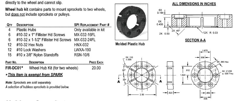

THere is an extra section in the manual that contains extra parts that are not in the regular Small Parts manuals. Appendix D
Looking at it the part # is
FIR-DC01 Wheel hub kit for 2 wheels
The coupler for the BOSCH drill is
FIR-DC02

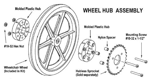

FOR SURE they were ordered from small parts and this was the schematic

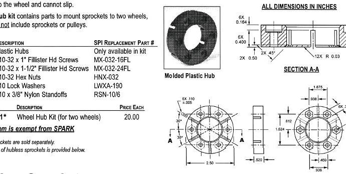

And these are the specs that were requested

**Also I spoke with Small Parts on the phone and the hub kit is no longer available.
The hubless sprockets which pair to the hubs are still available, though I couldn’t find them listed in the catalog online.
It is probably best that they are no longer available. The traction requirements of this and last year’s game pretty much rule out using those caster wheels. Order some keyed bearing hubs on your choice of skyway wheels. Order some keyed roller chain sprockets from MSC and you don’t need to mount a sprocket to the wheel hub. Much better mechanically and much easier to mount and change out sprockets.:smiley:
