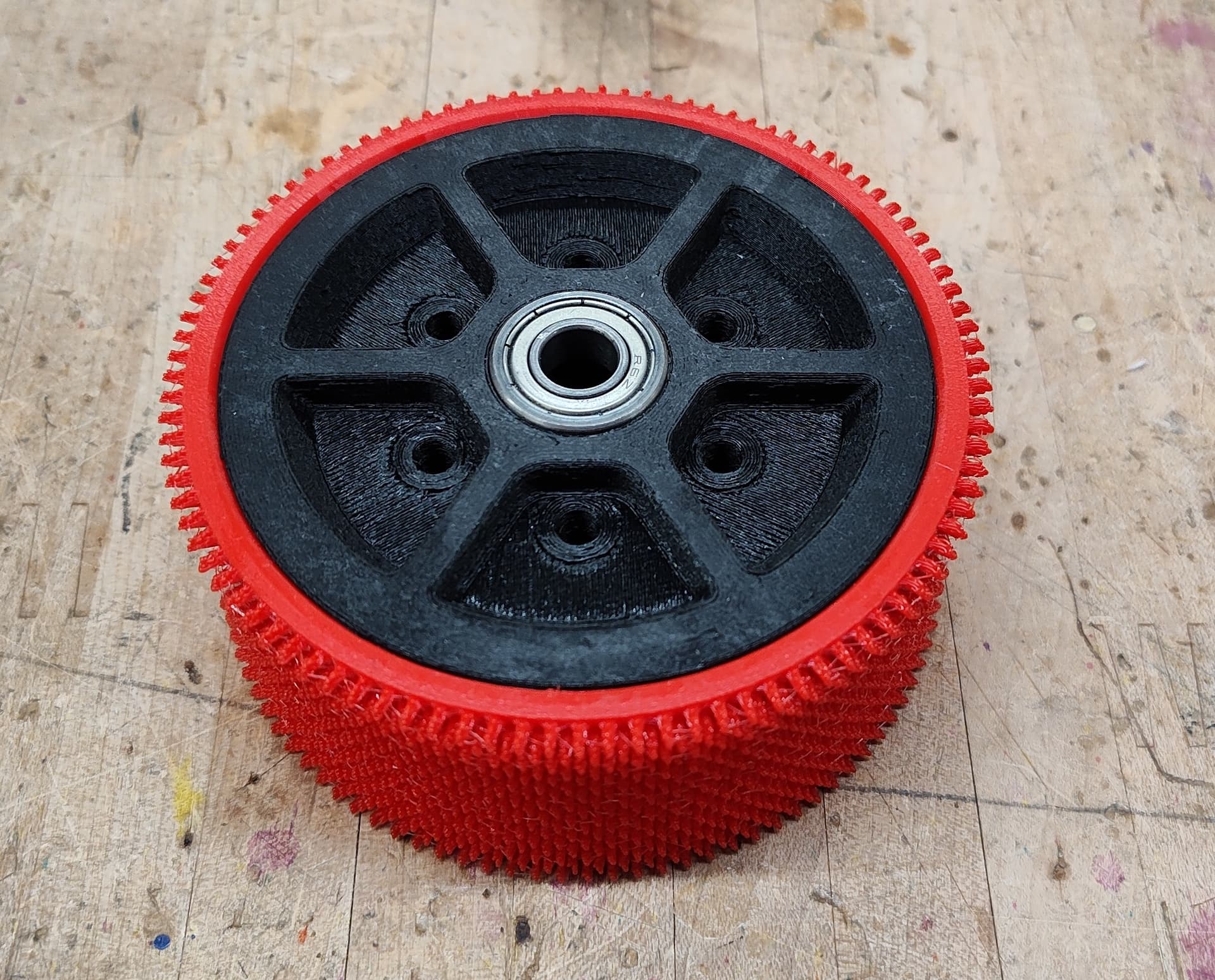

Do you have access to a 3D printer that can do nylon-CF such as a Bambu Labs X1C or a Markforged? I have a design for 3D printed swerve wheels that I was working on that I could modify for the MK2 and send you.

I have printed a prototype but have so far only installed some press-fit TPU tread since I think that is the way to go for this years field.

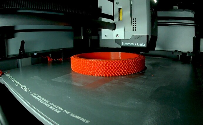

We printed the tread on a Bambu X1C from this design: TPU90A Grippy Tire CAD published (Finally) - #570 by veg

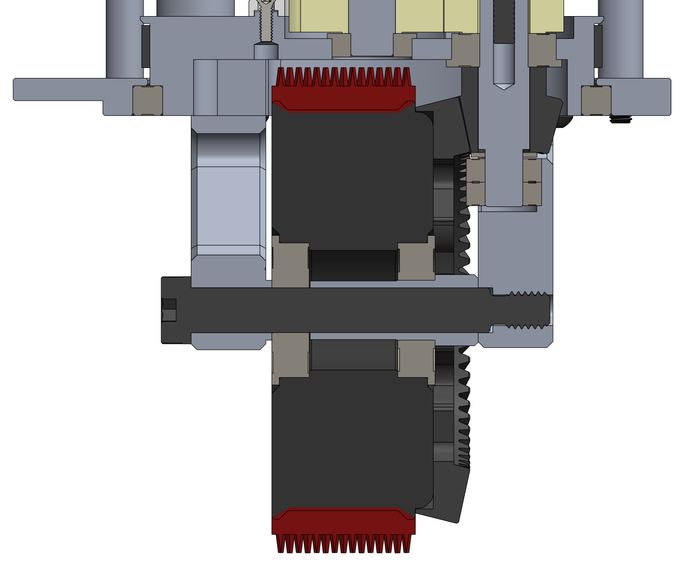

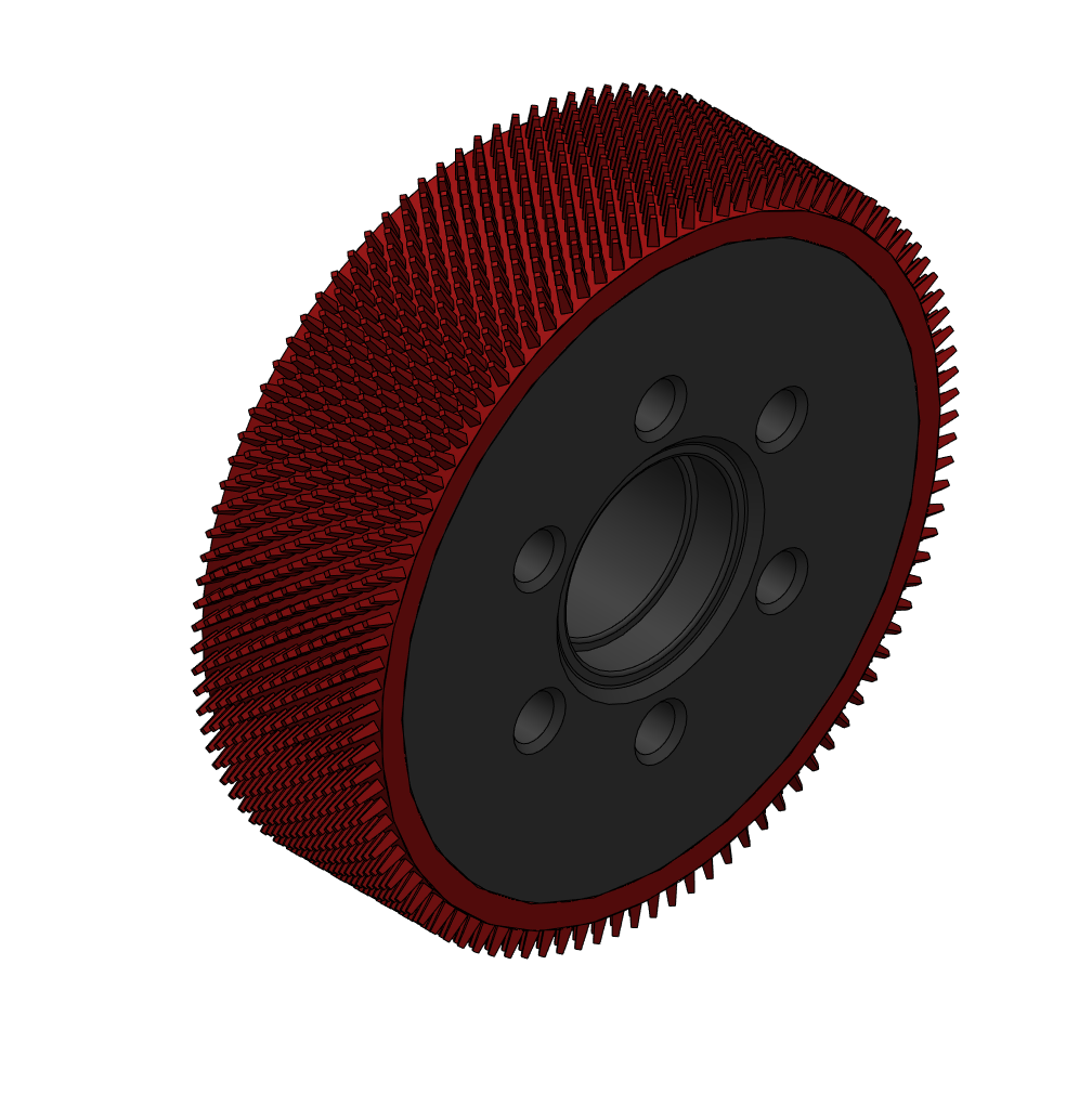

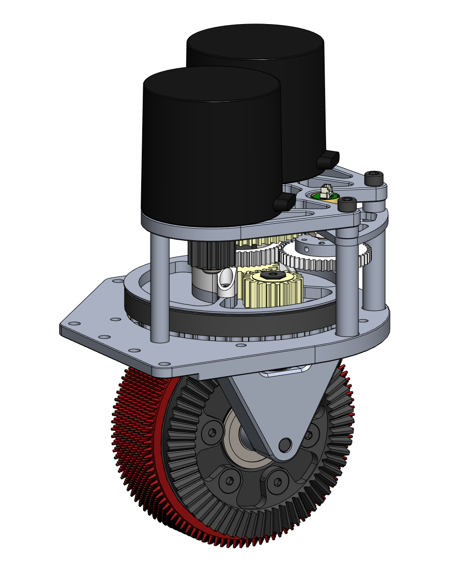

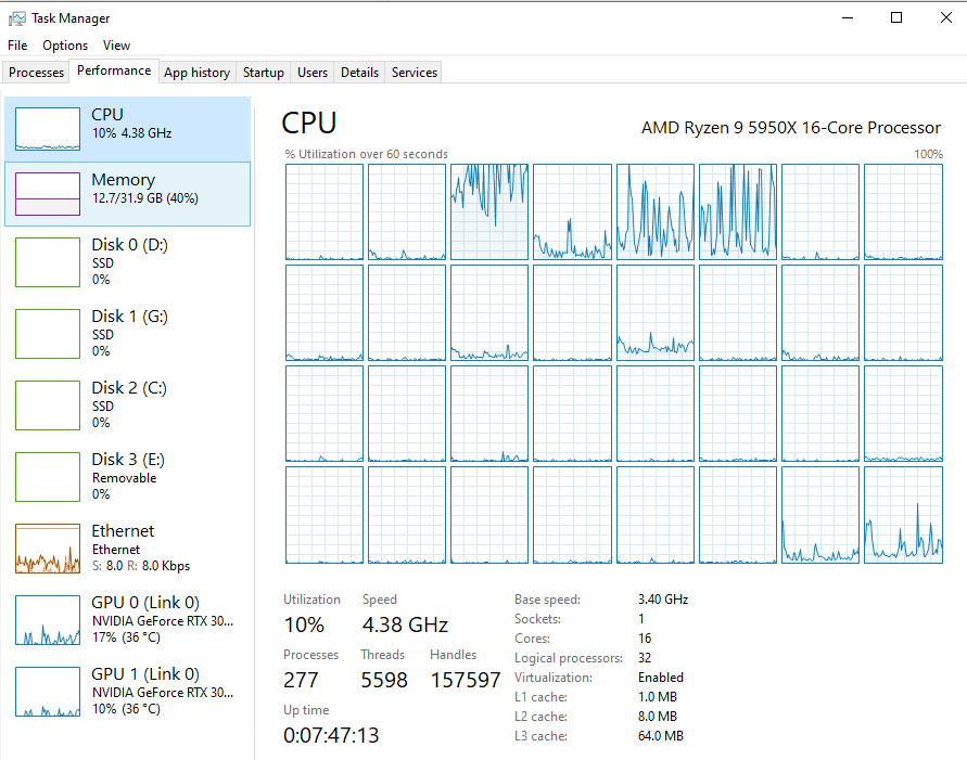

I just finished making a 3D printable wheel design for the MK2, but Solidworks is currently having a meltdown making the tread model to go with it. I should have it done in a few minutes.
Solidworks just melting that one core in particular as per usual:
Edit: Alright it’s done cooking:
Here’s the STEP file: Swerve Wheel With Tread 4in X 1in.STEP - Google Drive
Edit 2: Forgot to add, I sized the holes for heat-set inserts such as these. I did not include tread mounting holes but I can make a version with them tomorrow if you would rather bolt on tread.

I have a roll of Bambu TPU 95A HF, and I have read that it is really similar to the Overture stuff. I’m printing the MK2 tread with it right now:

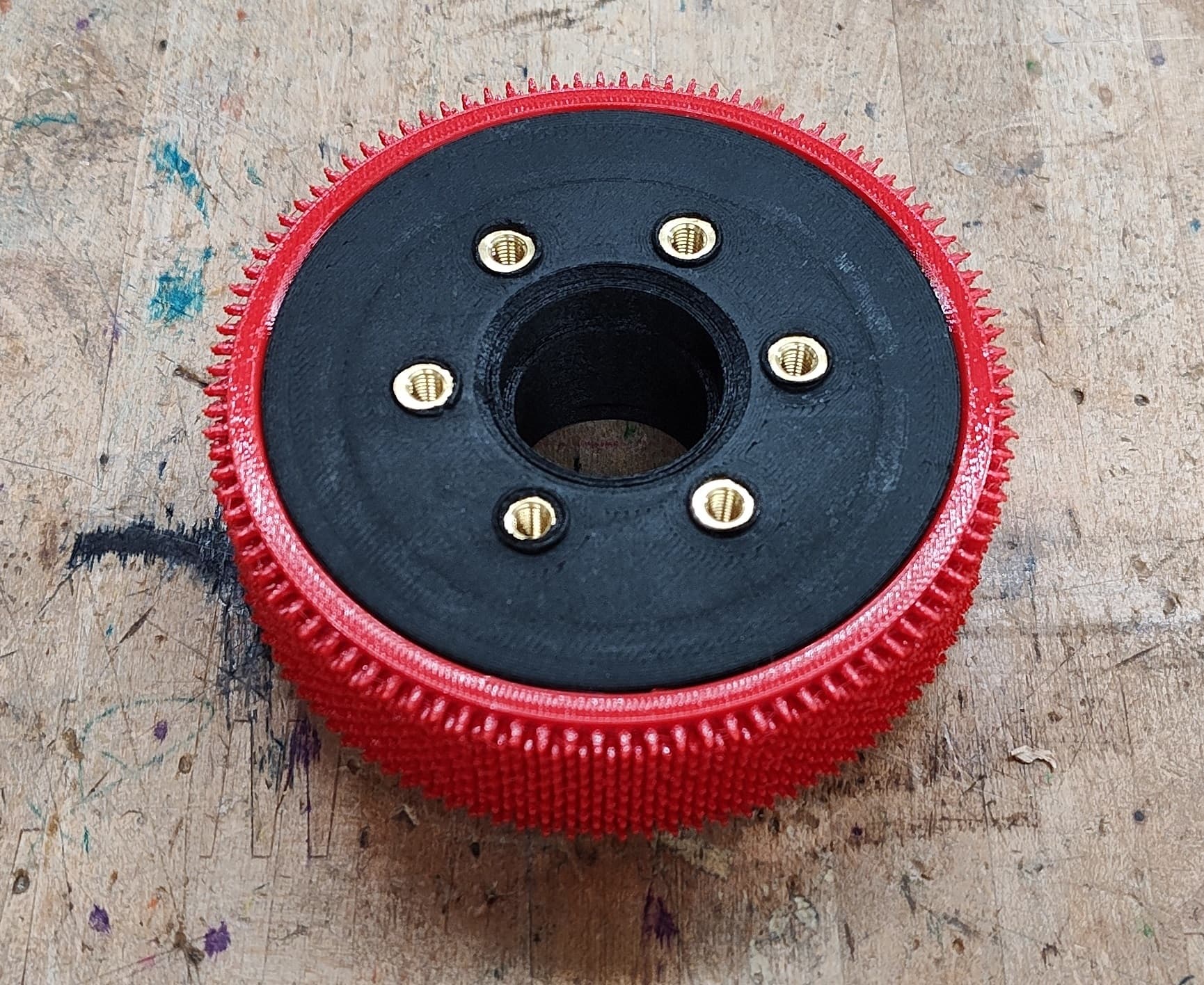

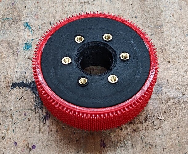

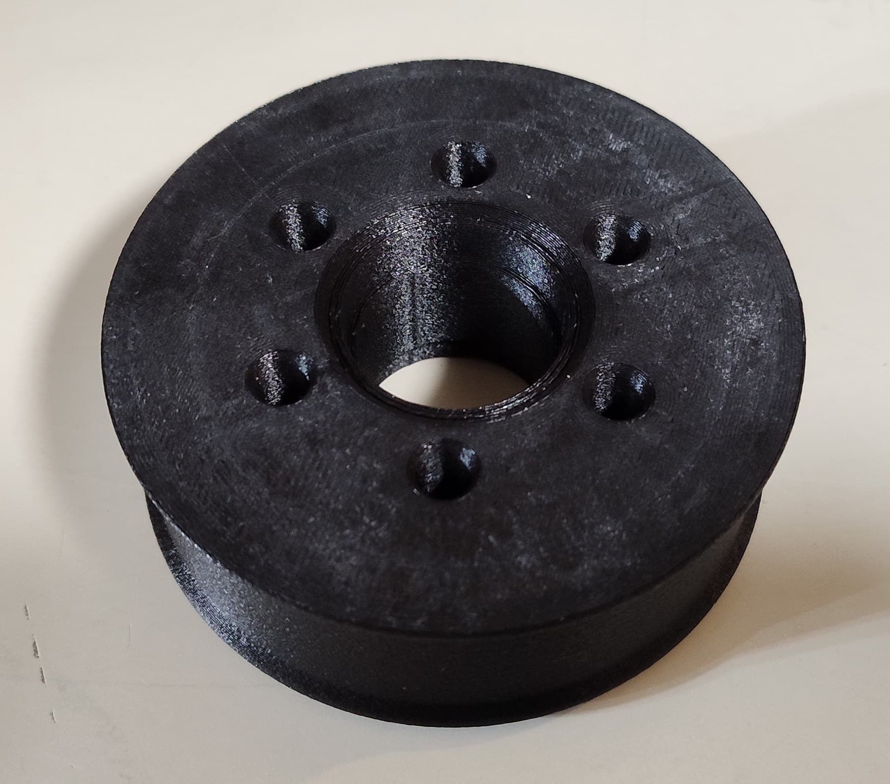

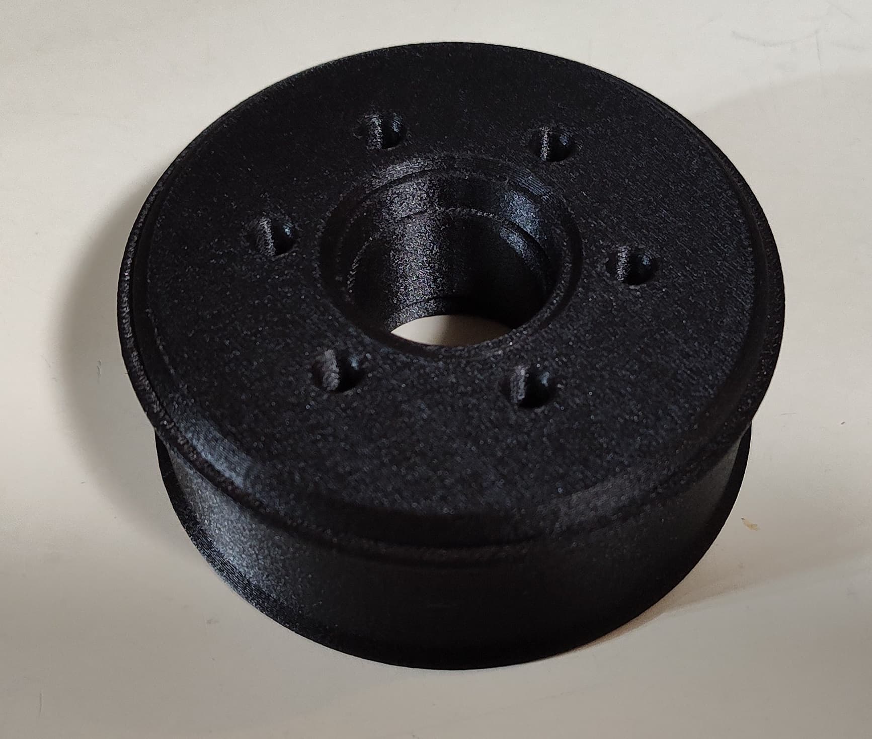

I printed the wheel overnight and it looks good:
Nice! You use the default slicer settings too?
For the wheel I start with the strength preset and turn on supports set to “snug”, and change the infill to gyroid or cubic (cubic has a higher potential to warp but is stiffer).
For the tread I start with the strength preset with support turned off, set walls to 2 and set infill to gyroid at 60%.
The holes are a little too shallow for the heat-set inserts to install flush, so I am going to adjust them. The tread spikes could also be slightly thicker at the base so I’m going to adjust that too.
They’re looking solid! How much filament for each wheel? Might be placing an order for some nylon soon.
Looks like 82g for the wheel and 51g for the tread.
