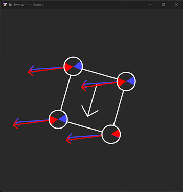

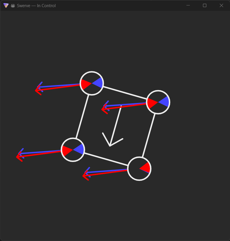

Could you use either Advantage Scope or In Control to display what your modules target vs actual behavior are to help identify the problem.
Would this working in teleop too or does it just take input from desired positions in auto?
This should work for both, I just took that screenshot while in teleop you just have to make sure you’re logging both your actual current state and your desired one (the one being passed into PID) This will show you if modules don’t line up if the controller is undertuned and will show them wiggle / oscillate if they are overtuned.
Awesome! Thanks for helping
If you need any help setting it up or have any questions just let me know and hope it helps.

Also, we occasionally have this issue with our front left module as well and are trying to figure it out. Might have to diagnose more at worlds unfortunately. A roborio reboot fixes it, if needed on the fly.
When it happens, can you check the status light on the turning Sparkmax? Does it change to red or green or stay blue/purple when you try to move? That’s what ours does. It’s like the Spark just stops greeting commands.
I’m using YAGSL not democat, but the symptom of the lagging turn motor sounds exactly the same. My current theory is related to CAN communication getting ‘bound’ up somehow. When I check my swerve states in advantage, the front left module turning state spins continuously around like it’s trying to catch up but since no commands are going to the motor or controller, it’s unable to get to its desired state. If I can’t figure out a way to fix this, some sort of module disable might be the only bandaid solution.
i have no real idea of what it could be but are all of your motor controllers and encoders on one can bus? i’ve heard that can cause control issues where the can gets overused and starts failing
This is exactly what is happening, yes. It seems we forgot to specify that it only happens in Auto and not Tele-Op, but it is nice to see that we are not the only ones with said problem. Our team will look into this and see if it works and then get back to you. Thank you from Team 85
