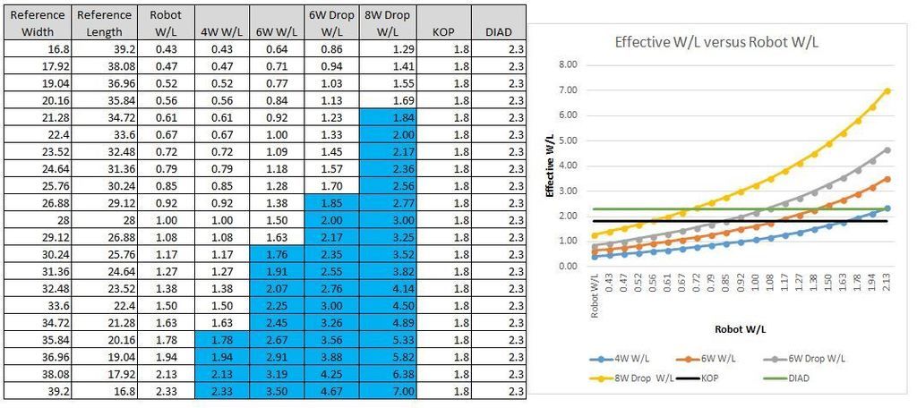

There are a few white papers and calculators out for this is well. I wanted to take a more simplistic approach to this and just look at wheel spacing ratios.
Assumptions:
  • All wheels are loaded and spaced evenly
  • 6 wheel no drop has 2/3 effective length of 4 wheel
  • 6 wheel drop has 1/2 the effective length of 4 wheel
  • 8 wheel 2 center drop has 1/3 the effective length of 4 wheel
http://i46.photobucket.com/albums/f145/Infinity2718/Spacing_zps9vhaygvp.jpg](Photo and Video Storage | Photobucket)
It seems the KOP drive is as good of standard as any in FIRST, which has had a 1.8 width to length ratio over the years. The current no drop KOP wide configuration has around a 2.5 with the 2/3 effective length of the 6 wheels. The drive in a day (DIAD) from vex appears to be around a 2.3 width to length ratio, but they have a few patterns to choose from.
Is the 1.8 number an acceptable minimum for width to length wheel contact patches?
Should there be a maximum width to length ratio?
Does center drop matter with length? (the opposite wheel clearance is twice the drop distance)
I don’t think it’s accurate to assume that the center wheels in a 6wd center drop are equally loaded. The center of mass is usually much closer to the center than either side of the robot and usually the center wheels take substantially more load (tread wear makes this very apparent). This means that teams can run quite substantially longer than the optimal ratio would suggest on a 6wd drop (see 2056 in 2013).
Aside from that nitpick this is a well done analysis. Please label your graphs better though. It’s hard to interpret a graph and spreadsheet of two unitless values where one of which isn’t properly labeled.
I’m not really sure where your numbers are coming from; are you assuming a certain length, width, or frame perimeter as constant, and what are you varying to get the different categories?
The KoP chassis does have a drop center, and can be constructed to several different lengths, which as I understand it, would change your numbers considerably.

Agreed, its really CoG dependent. This is more of a worst case scenario of centered weight on 4 of the 6 wheels.
The middle row is a square configuration for wheel contact of the outermost wheels (1.00 W/L for 4 wheels). The 4wd is the baseline, and the other wheel configurations are calculated based on the assumptions. They are unit less.

I have edited the post with reference lengths and axis labels.
