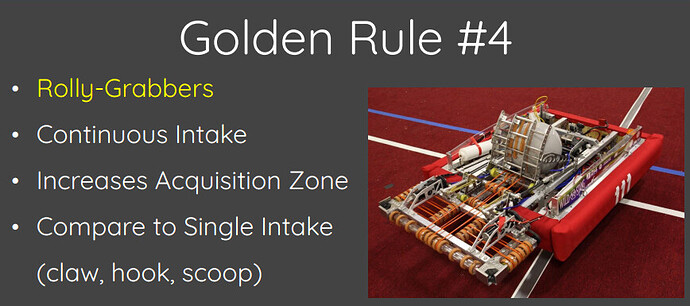

Courtesy of 1678: Always use a rolly intake. Watch any Einstein match from any year any year since 2012. Every robot on the field will have rolly grabbers.

Gawd damn that acquisition zone is as big as an ftc robot
In all seriousness you’re pretty much right as after doing my own research and looking at top scoring teams from TBA they all seem to have rolly intakes of some type. Even 1690 with their claw that defies physics requires an intake powered by wheels.

That was the point :slight_smile:
