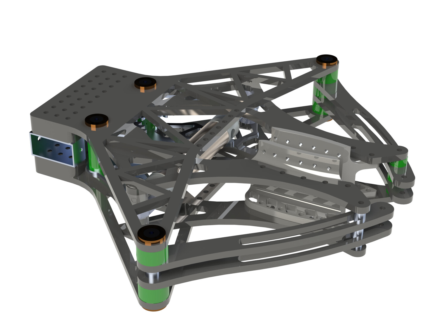

I may have had a similar story
My team used a claw intake for our first 2 competition but we are going to change it to wheeled intake after observation of other teams using wheeled intake like 2075.
This game has been kinder to delicate ended effectors picking game pieces off the floor than I anticipated.
We’ll see if that changes with the developing game meta.
huge kudos to you guys for coming up with that claw, it works amazingly
