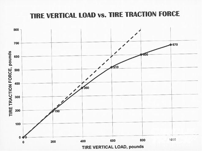

Here is a generalized plot for car tires. I suspect the same behavior applies to other polymers, like FRC wheels. Note the idealized dotted line.
Some of the mechanisms are explained well here: Tire Technology, excerpt from The Racing & High-Performance Tire
There is also an argument to be made that larger diameter wheels have more traction than a smaller diameter wheel with the same tread and width. Larger diameter = larger contact patch = lower contact pressure = better µ. I thought a team did testing on this, but I can’t find the information.

But, again, wider tires usually result in more grip because of load sensitivity. Why does tire width matter here? All else being equal, wider tires will experience a smaller change in contact pressure compared to a narrower tire for the same change in load. Smaller pressure change = higher coefficient of friction = better performance.
Is this always true in racecars? No. You can go too wide, to the point where the tires can’t get into a happy operating temperature or other effects ruin your day. But generally speaking, and within practical limits, wider tires provide more grip than narrower tires.
