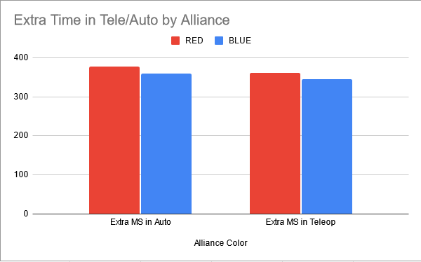

I’ve done some analysis using the data I have on hand, this includes all of our matches from both of our Michigan districts, I’ll add our regional and district championship matches later this week.
First, based on this data, I’ve determined that both the match and autonomous end when T=0 is displayed, with the exception of some “extra time”.
As Mechanical Advantage made public last year, matches aren’t actually 150 seconds long. On average, we’re getting a little over 700ms additional time enabled per match then you’d expect.
To break it down a bit more, from the time that T=0 is displayed, both alliances on average get ~325ms additional time in autonomous, and ~350ms additional time in teleop. The red alliance gets on average ~20ms more than blue in both teleop and autonomous.

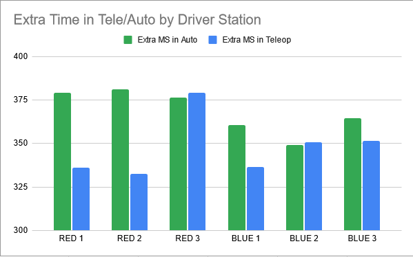

If we break it down even more, by driver station, you can see an interesting pattern appear.
Red still gets consistently more time than blue in autonomous, but in teleop it evens out except that red 3 gets on average 50ms more per match then any other driver station.
I’d love to have more data that disproves this, but there seems to be a clear pattern of “preference” for red, and specifically red 3 in both autonomous and teleop.
PS: 3005 was in red 3 during the match in question.

Is this similar visual data as you did in your previous analysis, or something else? Would you be willing to also share the raw data (or more stats). Curious what the distribution looks like.

This is using data logged from AdvantageKit, here is the spreadsheet I used to generate these graphs.
