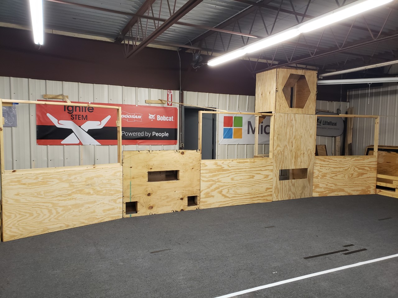

Where can you find 1 1/4 schedule 40 iron pipe for an Infinite Recharge practice field
I am working on building the practice field for my team for the infinite recharge game, but we are struggling to find the 1 1/4 schedule 40 iron pipe to create the generator switch practice element. I was wondering if any of you have found where you can buy it.

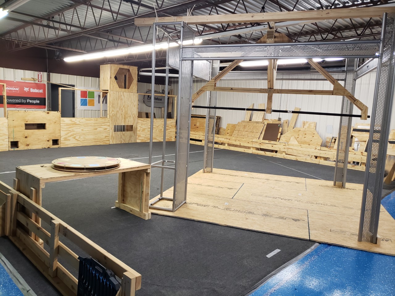

The game manual says the Rung is 1 1/4" schedule 40 aluminum pipe. You probably don’t want to use iron.
The team field build instructions specify black iron.
OK. Don’t know why you would use something heavier and harder to work with…
…and with a different coefficient of friction.
The main reason I can think of, is that you can probably find steel pipe that size.

We used black pipe, it worked very well. I picked it up at Menards myself. The black pipe is going to be more cost effective for a practice field and is easier to attach with the two floor flanges. Look at my post to see how we did it.
