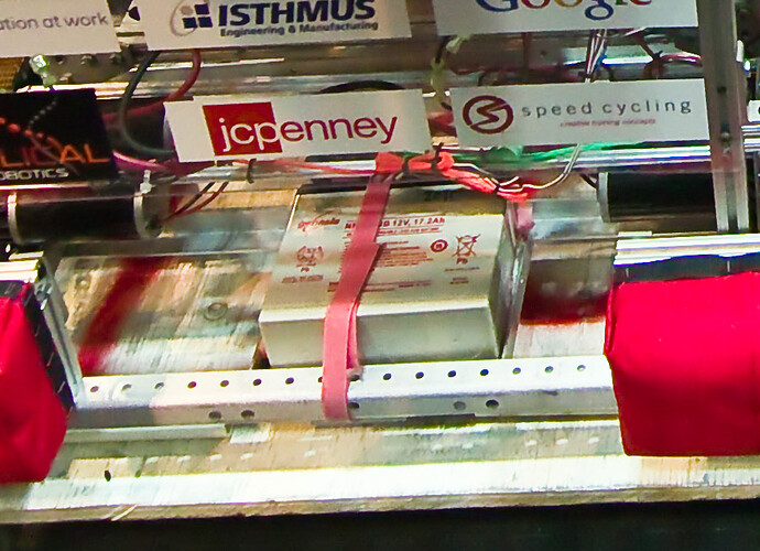

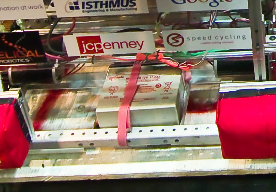

Here’s the battery mount from our 2012 robot. It uses angle on 3 sides with a strap and foam to contain the battery. It tipped over on the field several times without issue.
