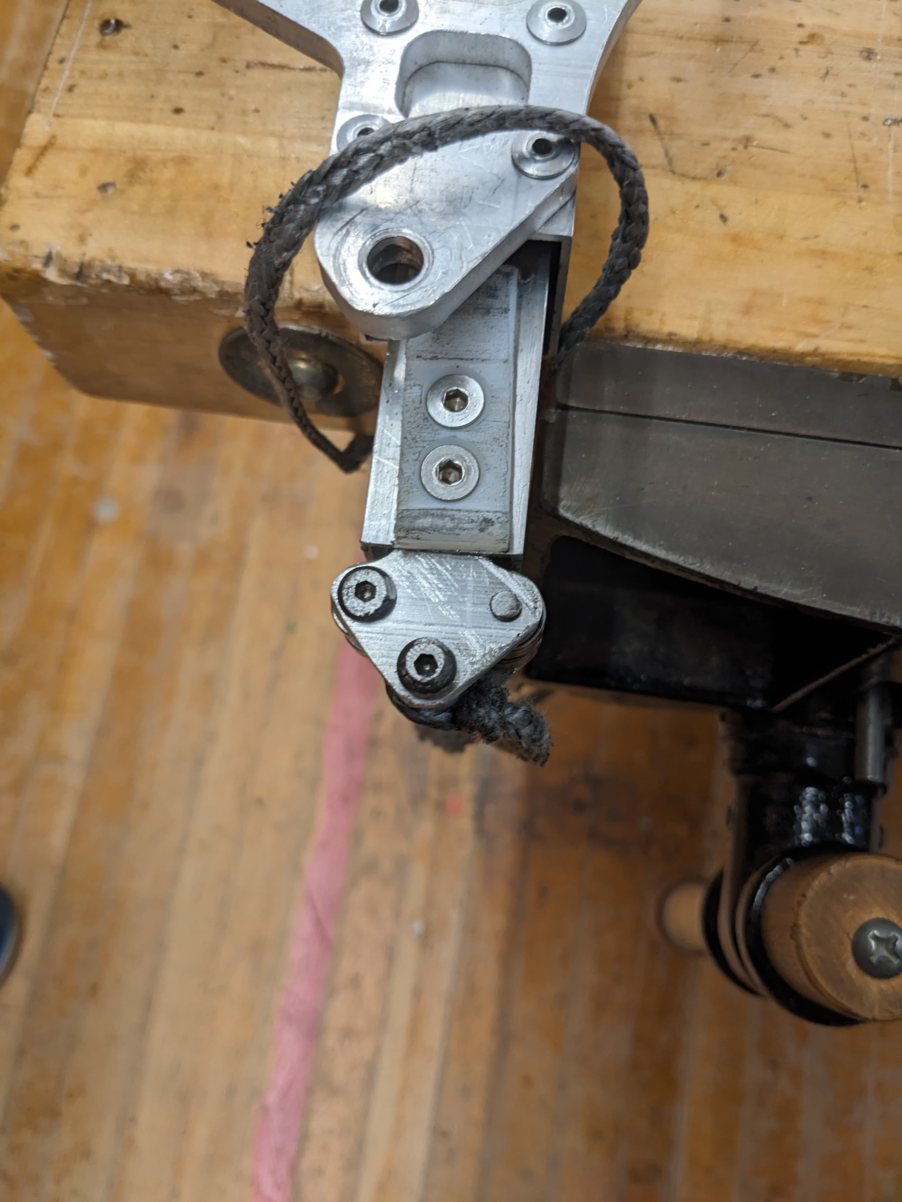

We went to McMaster and found the next size up that had the same length (I don’t recall what it was, but you can look there.
We used the TTB arm in both 2022 and 2023 – in 2023, we replaced the endblock with a 3d-printed endblock with 8 small ball bearings (McMaster 6383K11) and it slid A LOT better than 2022. Also helps if you tie the string at the close end, so you’re pulling the internal arm instead of the far one so you’re effectively pushing it.
We used 9293K12 from McMaster Carr and they worked exceptionally well. We did need to print new parts for the arms as the springs were slightly wider and we needed to compensate for that. We also used a replacement end block printed out of Onyx with bearings to allow a smoother extension and retraction. I can link our OnShape CAD if it helps with the files in it that we used.
In 2022 we used 4 bearing in the side of more force(forward/back) and slider plates for the other 2 sides.
(Orange 3D printed part was for a dry fit test)
