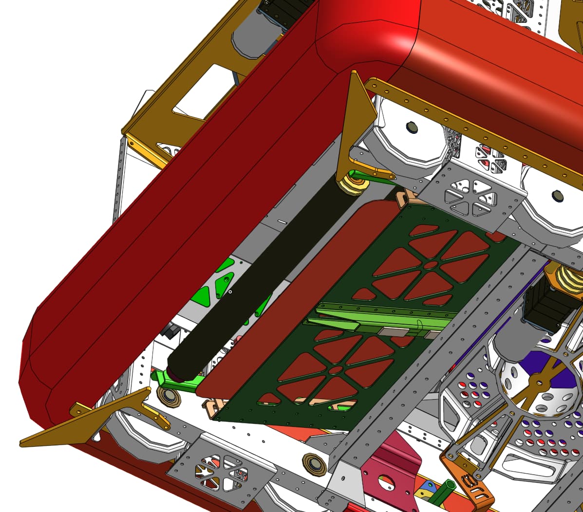

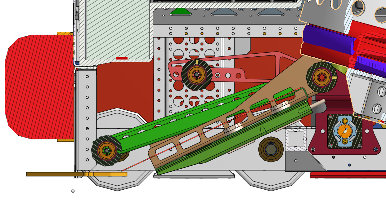

Which intake is robot use in this video
What is the question about it?
Not completely sure what you’re asking but seems like they’re using an under the bumper intake, where the intake rollers are within the frame perimeter, and the game piece fits underneath the bumpers. Something similar could be viable this year.
Here are CAD links
Onshape:
STEP:
It’s an under-bumper intake with a roller that pushes onto an angled plate.
The intake in the video is very cool and definitely would be good for this years game. It might have some problems as shown in this ri3d Video. I’m sure its doable though [https://www.youtube.com/watch?v=IdYKodhMz1A&t=2s]
