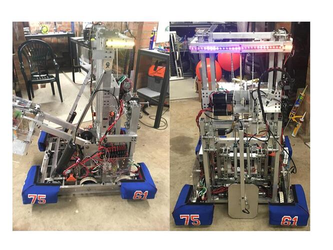

Initially our team used 2 775 pro motors on Cimile gearboxes and a 12.75:1 toughbox on a double cascading lift made from 1.5mm and 3mm 2"x1" tube with a heavy arm on it (extended from 4ft to 9ft overall) and had no issues.
First thing we did after official competitions was change to 2 NEO motors and was even better. Then we reduced the weight of the arm and intake and switched to minicims as we needed the two NEOs as a drive NEO burned out, we then had issues with the motors overheating and not providing enough power, assumedly because of the incorrect gear ratio for the power band of the motors. Setup can be seen in this image;
MiniCims were fine for the job, just make sure to use the correct ratio. As already mentioned it is more important to get that right then to have the perfect motors. The size of the pulley/sprocket also has an effect as this changes the speed that the mass will move per revolution.
Next year we plan to upgrade to our new custom 3 NEO gearboxes at 12.75:1 for even more power with a lighter elevator by CNCing lightening holes (if it comes to that).
