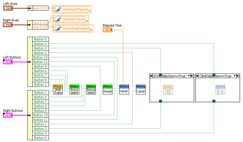

We are using LABView. But we are also using library’s and sub-directories to maintain organization. We currently have a library for each ‘component’ of the robot stored in its own sub-directory.
Chassis
Shooter
Climbing
Hanging
Intake
User Interface
File IO
Test
Each library is organized in the same manner:
<Library>Open.vi - called from Begin.vi
<Library>Close.vi - called from Finish.vi
<Library>Disable.vi - called from Disable.vi
<Library>ControlLoop.vi - called from Periodic Tasks.vi
Then there are <Library>“specific”.vi’s for library specific actions.
In addition, we are using the “Conditional Disable Symbol” to allow us to selectively include/exclude portions of the code depending on what we are looking to do. For example: our practice bot does not have any physical Intake or Hanging components, so they are disabled. No code related to the Intake or Hanging will execute and no errors are generated because the physical devices are not present.
And the code can be as clean as you want it to be. See attached screen shot.
The code I saw was incredibly complicated due to it being for some piece of random hardware. It was pretty messy. But you are correct, it does depend on the programmer and his/her practices. Our code is definitely a mess because nobody bothers to take the time to write it cleanly or clean it up after build season. Splitting projects into Sub-VIs (much like splitting a C++ project into different source and header files) would make things much neater. I think LabVIEW would be a nice thing to know, but I don’t see myself using it for something as relatively simple as the robot code.
