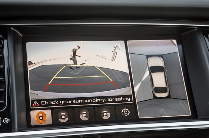

We have a functional 4 camera setup (1 for each side of the robot) that we plan on mounting to our robot very soon. It livestreams the video feeds over the network to a browser like in some vehicles’ backup cameras (
). With the advent of AprilTags, this can give us positional information no matter where we are on the field. This can all be done on-bot with a coprocessor, but we won’t be able to get live video feedback, or if we do it will not be all videos at once and they will be low quality with low FPS.
