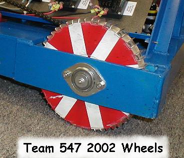

We experimented with cleats this year. We built some prototype wheels and even a test jig with spring scales for testing traction. We ultimately settled on the cleated design you see in the picture. The wheels are 3 layers of 1/2" plywood with 1/2" C-channel aluminum for the cleats. They were definitely above average on traction but not as good as those beast machines. We could easily be pushed around sideways. We will probably try something else next year.
Our wheels:
