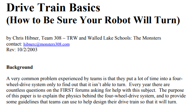

Also, look here. It was one of the original viral white papers on CD, back when that was a thing.
Abstract

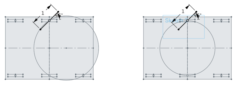

A quick way to visualize this. An outline of a robot, with 2 wheels in each corner (dimensions 25x35). The circle intersects the middle of each wheel, and represents the path the wheel takes when the robot spins in place.
The dark black line on each robot shows a 45 degree difference. In the case of the robot on the left (a wide robot), this shows that the wheel travels “more forward than sideways” while turning. In the case of the robot on the right (a long robot), this shows that the wheel travels “more sideways than forward” while turning.
There’s no hard and fast rule i’m aware of (it depends a lot on the specific coefficient of friction between the carpet and the chosen wheel), but the more “forward than sideways” the wheel travels, the easier it is for the wheel to overcome the scrub and rotate.

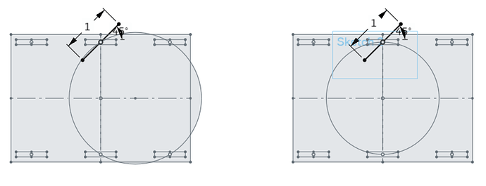

Updated example for a long robot with a drop center below. In the first one, the center of gravity is significantly off-center, resulting in 4 wheels on the ground pretty much all the time. In the second, the center of gravity is centered, allowing the robot to rock back and forth as it turns, essentially letting it spin right on its center wheels. You can see how these circles change the relationship versus the long robot above - the first one has a slight advantage of “more forward than sideways”, while the second has essentially no sideways motion, as it’s tangent to the circle!
With the center pair of wheels dropped, [at least] two of the wheels aren’t on the carpet at any given time. The wheelbase for turning purposes is therefore the distance between the center and either front or back wheels, not between the front and back wheels.

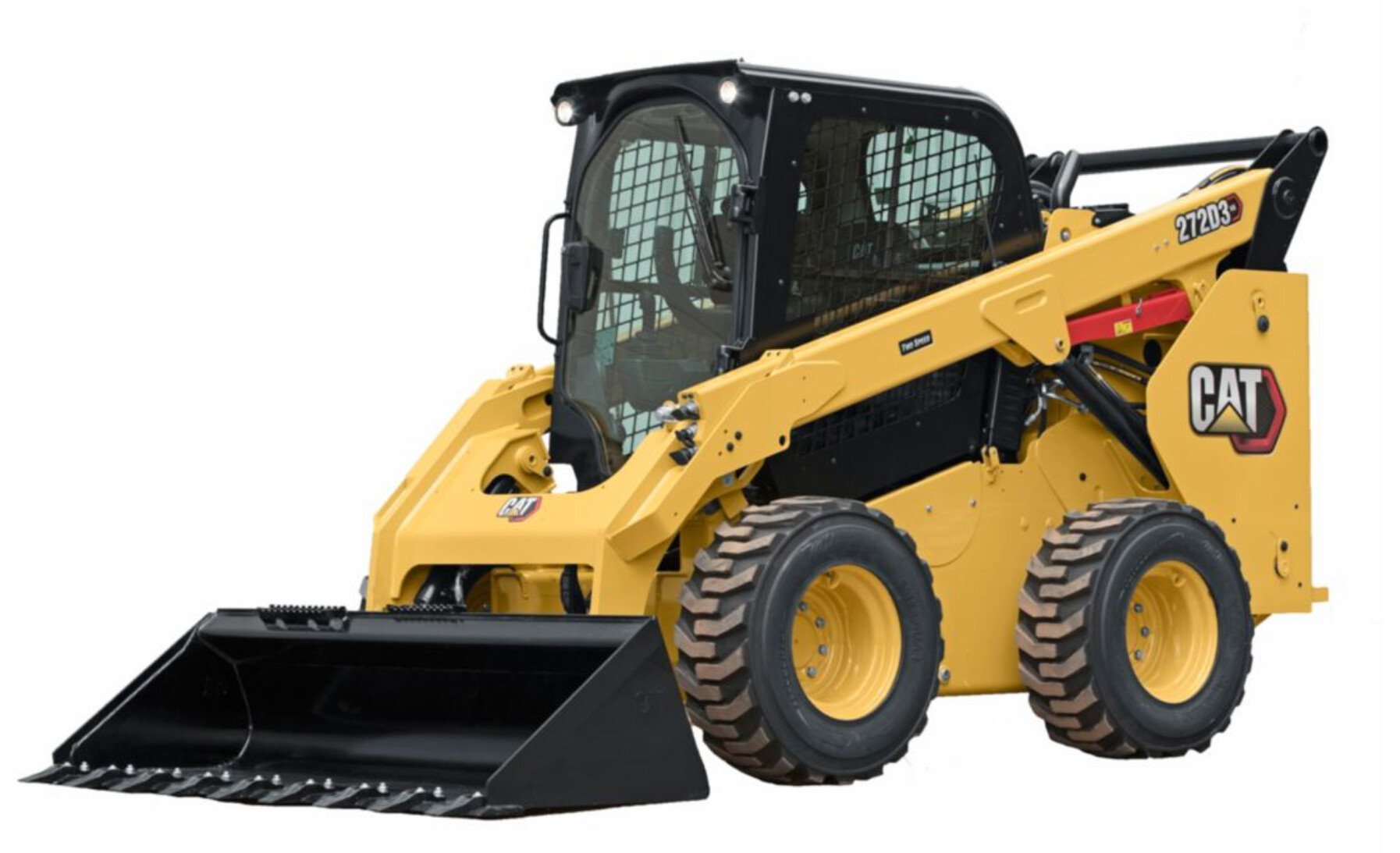

FWIW - there’s a product out there called a “Skid Steer” with the configuration you mention. So named as the steering is accomplished by the wheels skidding laterally along the ground.
There is considerable design work to ensure the wheelbase is correctly dimensioned, and the center of mass remains nearly in the center of the wheelbase, even through the loading cycle.
