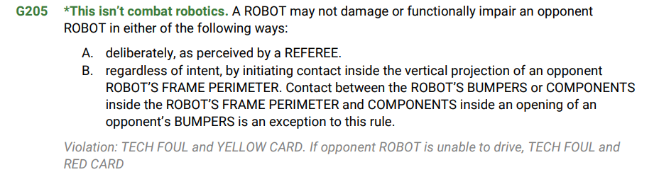

Per G205, damaging contact within the frame perimeter is forbidden. If this contact results in the opponent being unable to drive, then the penalty escalates to a red card; and in eliminations, this applies to the entire alliance.

While I agree that the call by the refs was correct, This rule should not exist. It is nearly impossible to intentionally shut off another teams breaker. G205(B) could be completely eliminated from the rule book. Robots should be designed so that components are adequately protected.

The only reason no one intentionally shuts off another team’s breaker is because G205B exists. It HAS to be against the rules to do it. Having a clause escalating the penalty only if done intentionally or with a mechanism outside the frame perimeter would help prevent a situation like this.
It’s tricky cause the rules state the main breaker must be “safely and quickly accessible” to some extent (R612), obviously I don’t think 3015 did anything on purpose, but I don’t think you can remove G205(B) and still make R612 reasonable.

It may not have been intentional, but it’s a rule in the rule book and should have been called.
Yes we contested the call in both match.
To add to this though, in respect to the rules that FRC currently has, I think the referees made the right call here, R205(B) was definitely violated when contact was made with 340 that breached their frame perimeter causing their breaker to end up being shut off.

Isn’t this covered by G205(A)?
