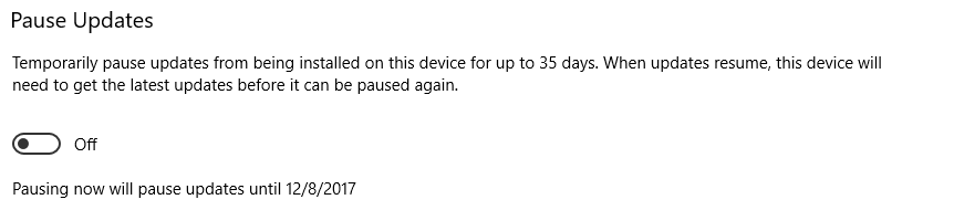

I don’t recommend not installing updates. Last year the National Instruments code would not run without important updates from Microsoft that were released in August. NI also only tests with the latest updates installed. If you have a problem with NI software and don’t have the latest updates installed, I suspect there won’t be any help from FIRST/NI when things don’t work.
PCs should have all updates applied before coming to competition.
At competition, turn automatic updates off, so that they don’t happen to occur when you are starting a match. Teams have had to be bypassed when their driver station PC started to update or got locked into finishing an update when it’s time for the match to start.
I’ve seen PCs stop to do a Windows update in the middle of a match.
Then turn updates back on after competition.
This switch (Settings -> Windows Update -> Advanced Options) is particularly useful.
