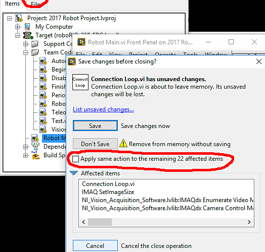

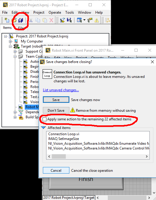

I usually hit the Save All button on the project explorer window as soon as it comes up and that seems to avoid the problem.
When surprised with Saving a bunch you can click the box on the Save popup for Apply same action and just hit Save once.

Unfortunately, the RT loader does a poor job of consolidating the items that need to save and showing you a single dialog. This seems to happen most often when you first start to use VIs and they either had a version change or a perhaps the code was once Intel and is now ARM. As Mark said, the best workaround is to do a Save All.
Sorry for the odd behavior.
