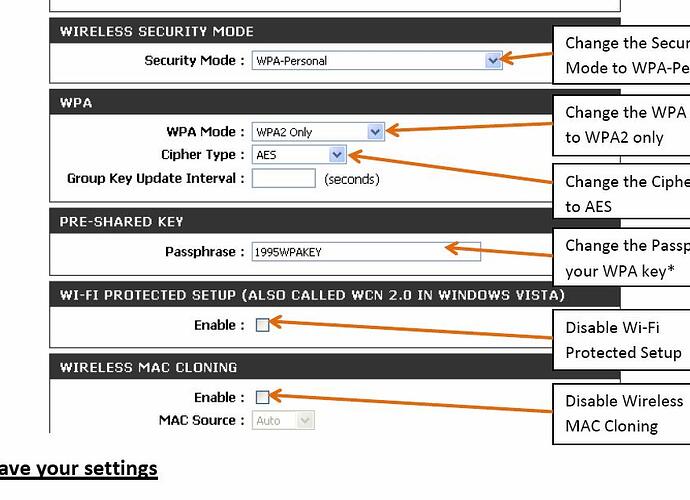

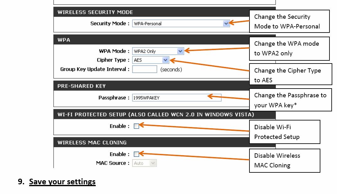

As per this document, they were instructed to enable WPA-AES security and enter a passphrase (see the attached picture). We used 3518WPAKEY as per the example. I told the students that we would be getting a different, random and unique passphrase at the competition.
If there contradicting instructions in a different document, I would appreciate it if you could post a link.
Thanks,
Mike
That’s only the first half of the instructions. It’s specifically the “Configuring a radio for Competition” part. I don’t know why it’s in there, because it isn’t how anyone is expected to use the system during development, and I think the settings should all be overwritten anyway when the kiosk does its stuff at competition.
The rest of the instructions, under the heading “Configuring a Radio for Access Point Use”, tell you only to set the SSID and frequency band. The security remains disabled under AP mode.
Alan,
Because of your competence in such matters, I hate to disagree. But… It works just fine in AP mode when the WPA-AES is left on. You only have to enter your passphrase into the driver’s station (and development station, if separate) and it works like a charm. This is our development configuration at Lecanto HS.
Nowhere did I see where WPA-AES was optional. The section it was in is titled “Configuring a radio for Competition:”.
Regards,
Mike
To sound less blunt, the access point can be used with security, but any problems with it are less of a problem than to use without security. What is someone gonna do, access your cRIO? lol.
Having security on the D-Link in Access Point mode works fine, certainly. It’s just not how the instructions tell you to set it up. I’ve not seen anything in the documentation that mentions having to enter a passphrase on the Driver Station computer.
Yes, the instructions call for WPA security when using the D-Link in Bridge mode. If you follow the instructions, however, you’ll be using it that way only at a competition event.
