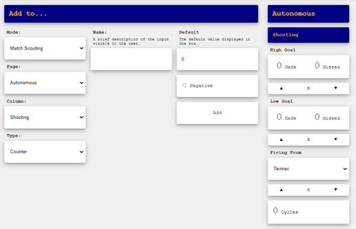

Config building – Building a scouting config requires no programming experience, simply make your categories and add one of our premade data types to it!
Config Builder

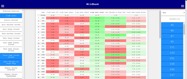

Pivot tables – The primary way to view data categories is through the pivot table feature. This page allows you to pick and choose what data is displayed from what has been collected, and which column the table is sorted by.

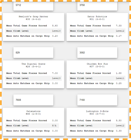

Coach values – Coach values gives a drive coach the ability to pick a few key statistics to be displayed in a match preview screen for quick reference when planning strategies.

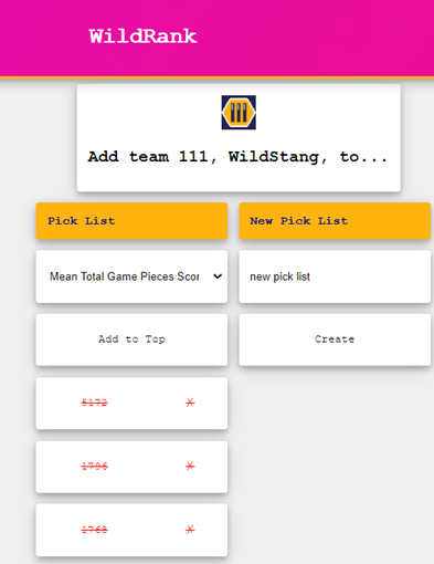

Pick lists – Pick lists can be created directly from a pivot table or smart stat page to pre-sort the team list by any stat, or you can make one from scratch! Multiple pick lists can be created and saved, and a team marked as picked on one list will be marked picked on all lists.

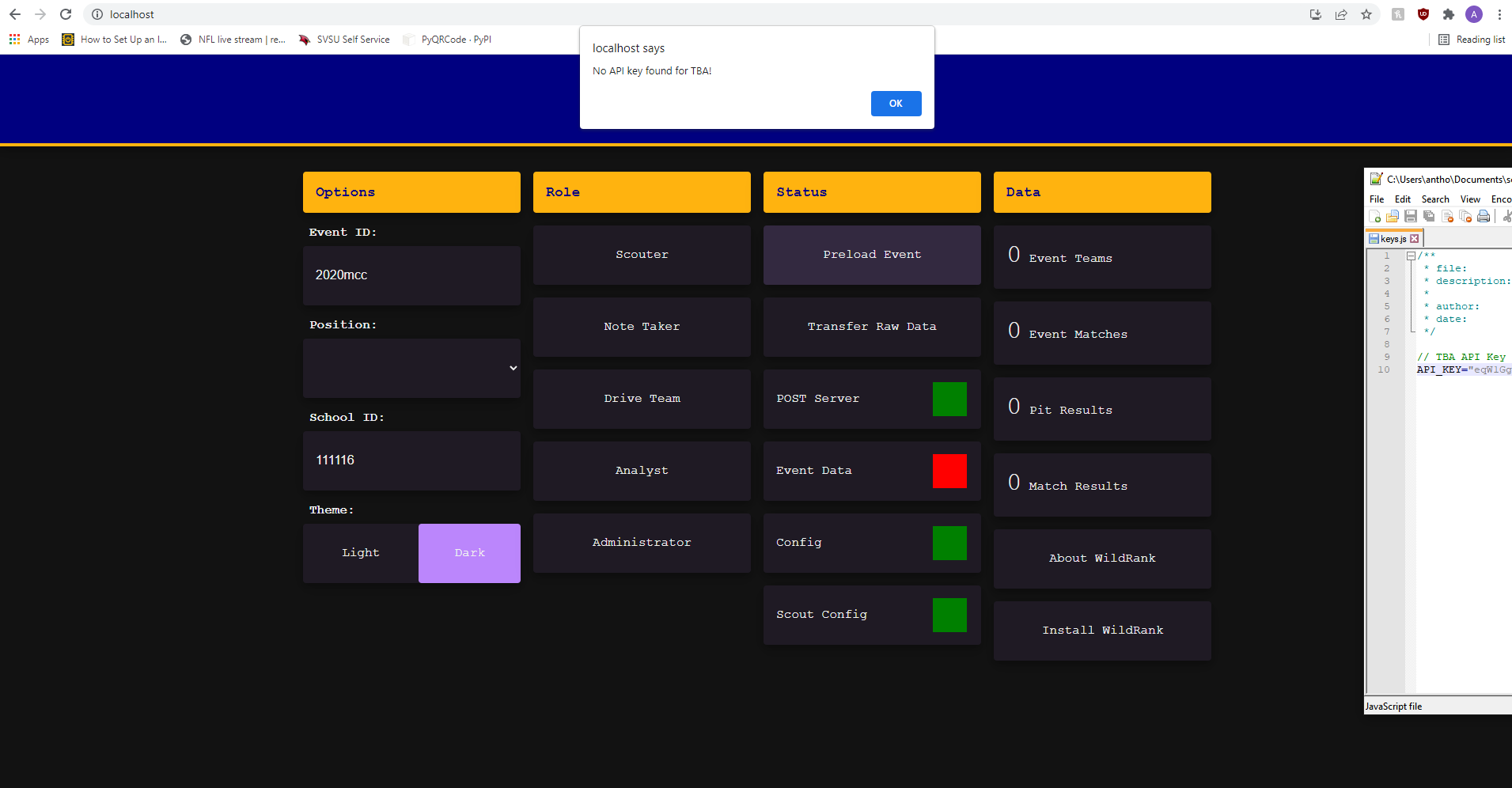

I really appreciate the work you’ve done on this - I have a slight issue where if I try to preload the event with the TBA key correctly placed in the keys.js file it still gives me a No API key found error. Would you be able to tell me how to fix this?

I tried pulling a match schedule from an already completed 2020 event (2020 macomb community college, and I did fix the event key after in the web app because it was wrong but it still gave the error), so that might be what’s causing issues?
Yeah, so in older versions, iirc, everything is parsed from the match schedule. This leads to stuff not working if the match schedule doesn’t exist.
All that is probably in this thread somewhere:
If you preload an event with no matches yet, it should return a pop-up saying “no matches received”.
Liam might have better guidance on how to troubleshoot, but my guess is it’s an issue related to the TBA key
Was hoping you’d see this thread, crazy to hear you’re still using v2!
With this version, matches, teams, and rankings are all individually pulled so if you get > 0 and < 3 you’d see an orange indicator instead of red.
@Anthony_Galea your problem is definitely a lack of an api key somehow. Can you PM me what you get as a result of navigating to http://localhost/scripts/keys.js?
An alternative is setting the API key as an environment variable. That can be done like TBA_KEY="blah" python3 python/post_server.py

We figured it out, it was due to the app’s caching, so here are a few notes on keeping your pages up to date.
  • Hard refreshing is the first thing to try after making changes, ctrl + F5 on Linux/Windows should trigger it but sometime multiple tries are required
  • App storage can be reset with the “Reset App” button in the Administrator role
  • Finally developer tools can be used to really clear everything out, ctrl + shift + i will get you there. Then under the “Application” tab click the arrow next to Cookies then right click the url below and select clear.
For any potential developers out there to force the browser to look for new changes change the CACHE_NAME variable in pwa.js when you make changes
