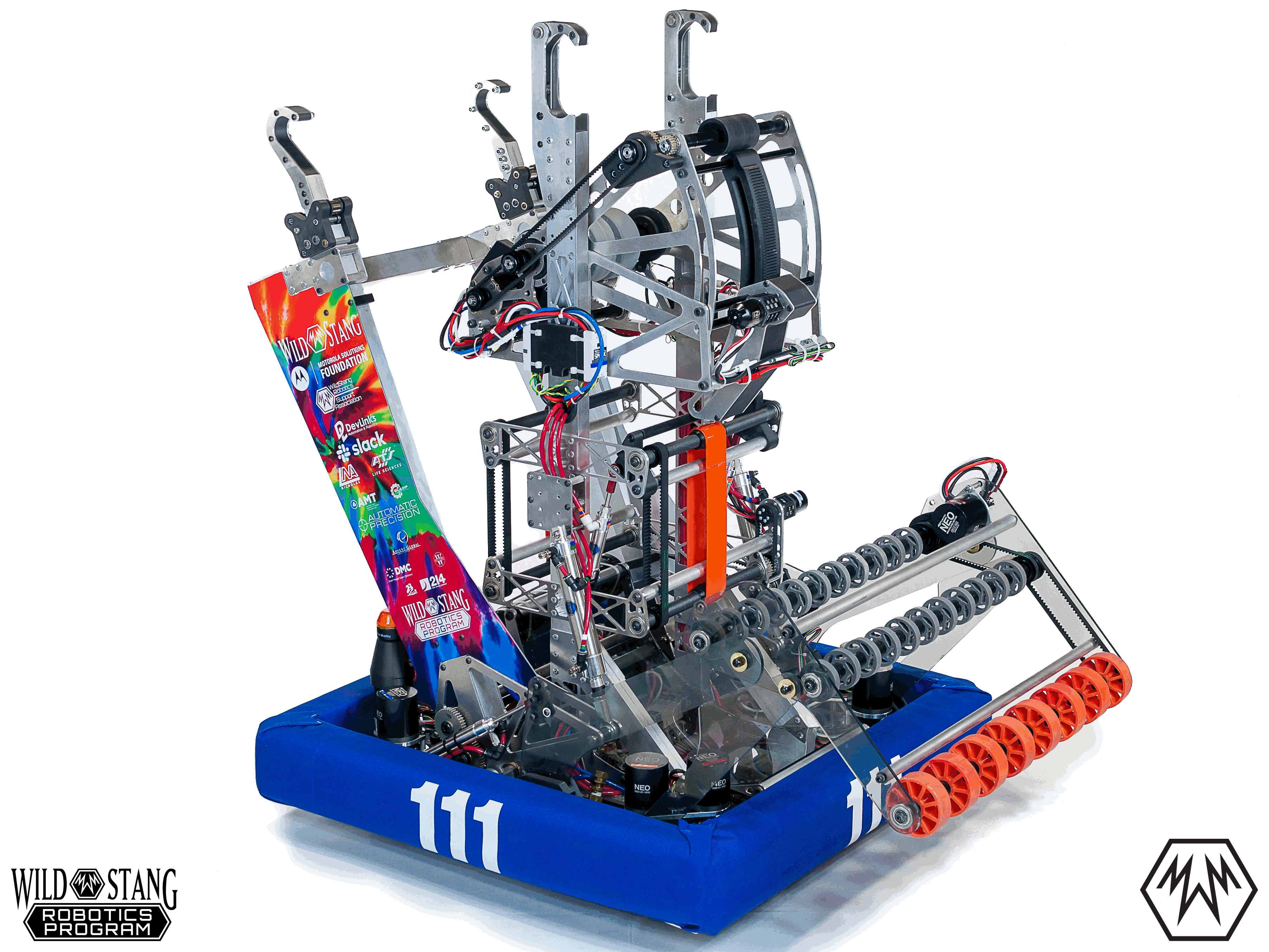

Team 111 WildStang is proud to present our 27th robot for the 2022 season!

The packaging on this robot is beyond beautiful. If it performs half as good as it looks you’re in for a fantastic competitive season.
Oh yeah, this is a Wildstang robot. You love to see it.
Amazing! Can’t wait to see WildStang at CIR!
How much does this weigh? It looks light
118 and change.
Was 108 but we ballasted up to push CoG lower.
SWERVE!!! swerve swerve swerve!!!
Only took 27 years
How high up is the COG? It has to be super low, the top of the robot is 99% air!
9ish inches per onshape.
26” sq drivebase.
Low COG and on a frame perimeter diet. Nice.
So there is a ten pound chunk of weight down low? Very good! Now you can drive with impunity.

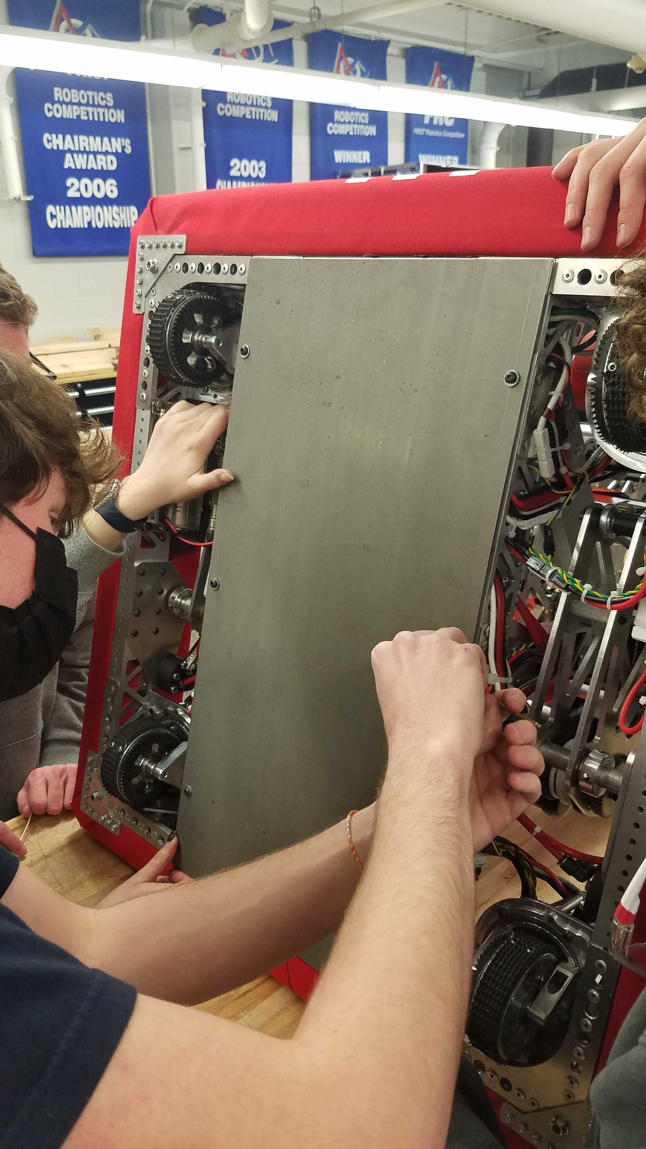

13x26x.100”ish steel plate on the bottom.

Love the underbelly steel plate we did that in 2021.
Do your bumpers mount from under the robot?
Figured low CoG = good. Got the idea from Spectrum. Easy enough to swap to poly if we decide we don’t need it down the road.
Yes undermount bumpers. Kinda terrible but it was easy. Live and learn.
