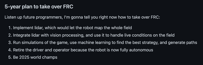

Our 2019 programmer was insanely good. He left this in the readme…
971 I am looking directly at you guys.
