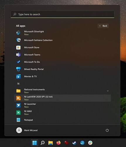

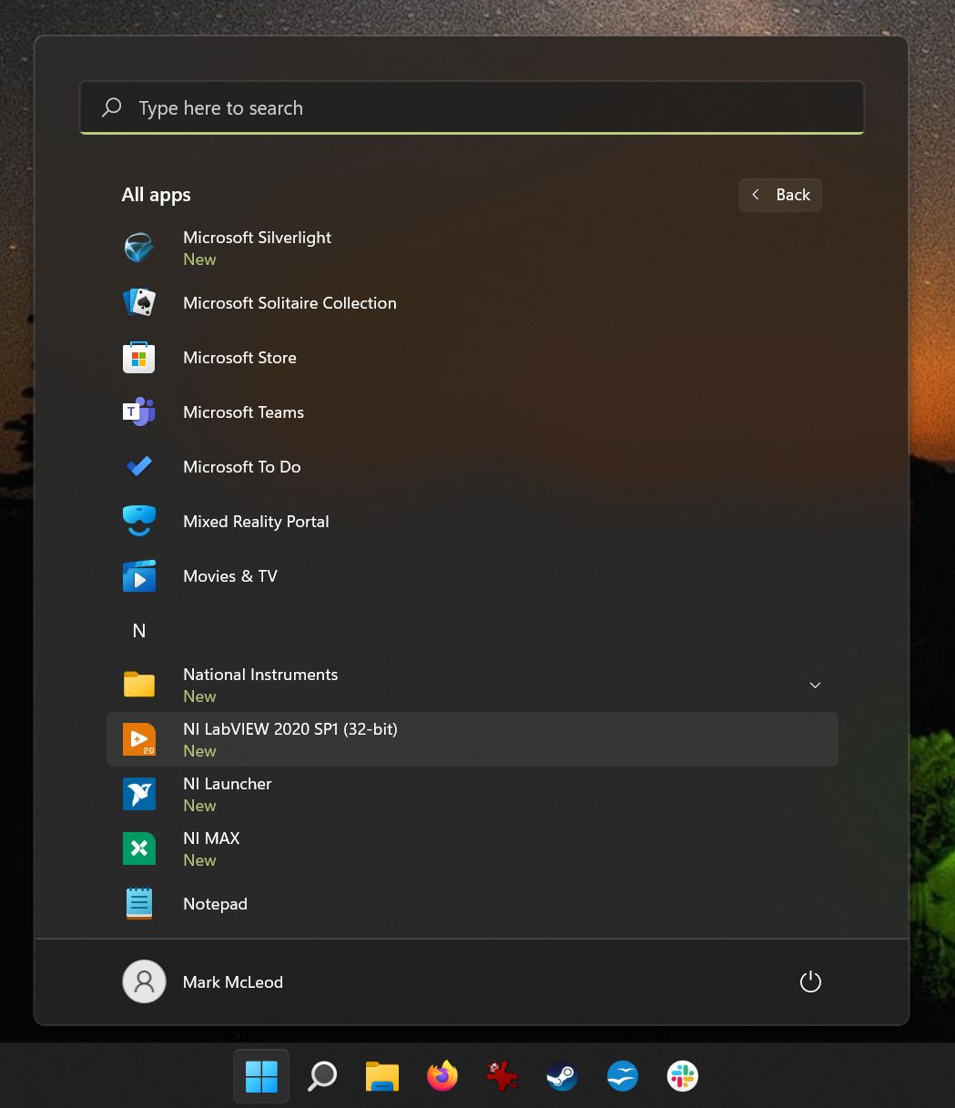

Just purchased new laptop to replace 6 year old laptop used in FRC 2016.
New laptop has WIN 11, so struggling through new everything.
Installed FRC Labview and FRC game tools following the instructions.
Crio and dashboard icons are present. Where is the FRC Labview launch
executable in the file directory?
Thanks in advance,
Should be under Start(bottom center left)->All Apps (top right corner)
then National Instruments
or if you really want the directory path it’s the same in Win 11 as it is for Win 10:
C:\Program Files (x86)\National Instruments\LabVIEW 2020\LabVIEW.exe
