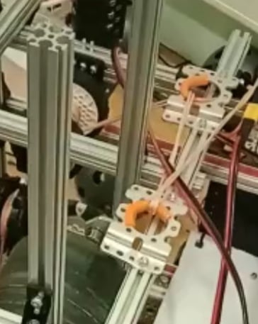

I made a winch by using an hd hex motor with Ultraplanetey gearbox the ratios are two 5;1 and one 3;1. Then I put 30 tooth plastic gear with the motor and a 45 tooth plastic gear with the spool. Then I had to pass the UHMWPE cord from two motor mounts so I can balance the weight but could be they are slowing the motor down .The only problem I got is that it’s very slow in getting up .Is it ok to lift directly from the winch as I’m afraid I make damages .IMG_20221006_123321

For the record, I suggest using pulleys to redirect your line, instead of motor mounts. But let’s look at the overall system first.
There would be a lot of friction passing the cord through those motor mounts like that - we’ll get to that later. With two 5:1 and one 3:1 stage, followed by a 30:45 stage, you have a 112.5:1 overall reduction on a motor with a free speed of 6000 RPM and a stall torque of .105 N*m.

Now, if we build it that way and it doesn’t work, we need to figure out why. Either something was off in our calculations, our weight measurements were wrong, or we didn’t take something into account - in this case, it would likely be friction from those motor mounts - you’d need to increase the gear ratio in order to overcome both the weight and the friction in the system.

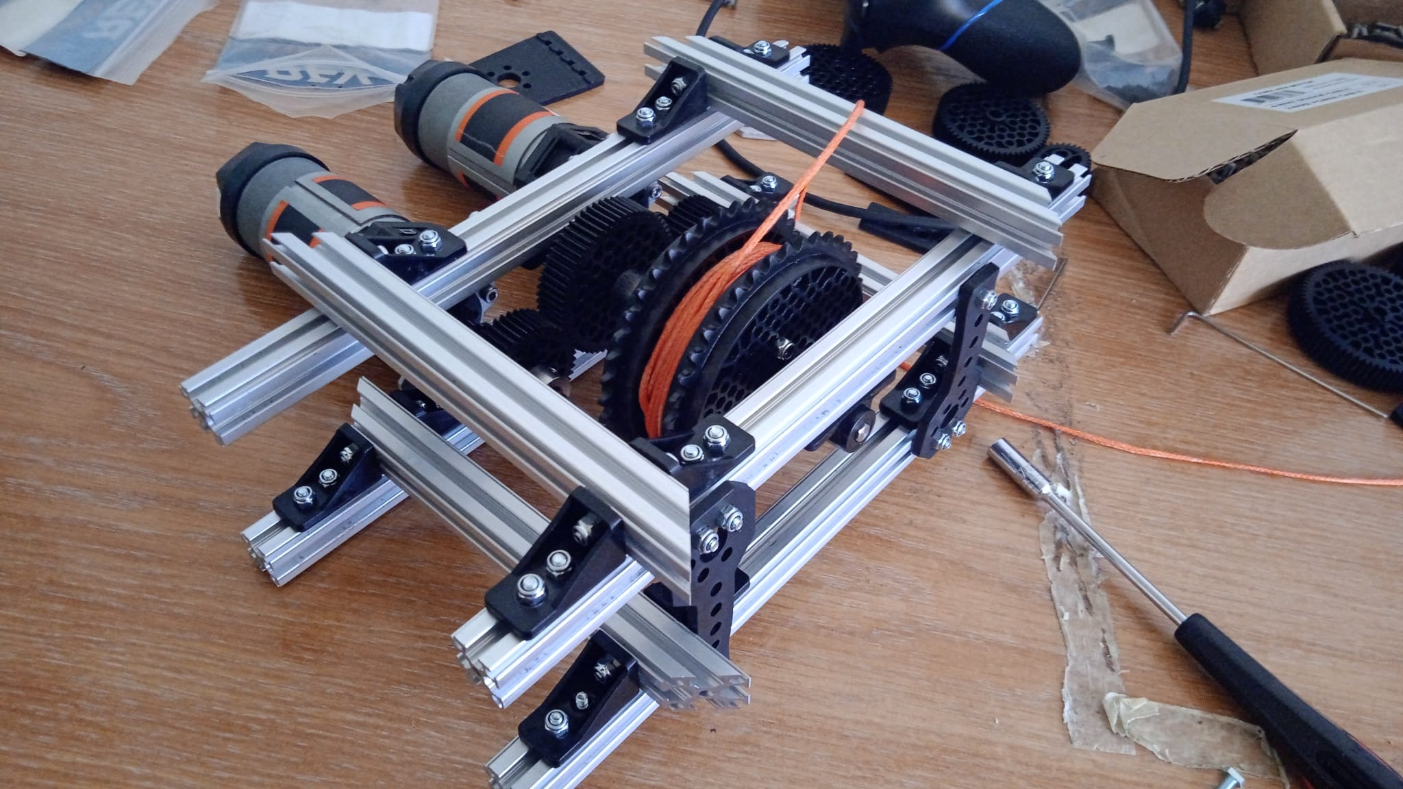

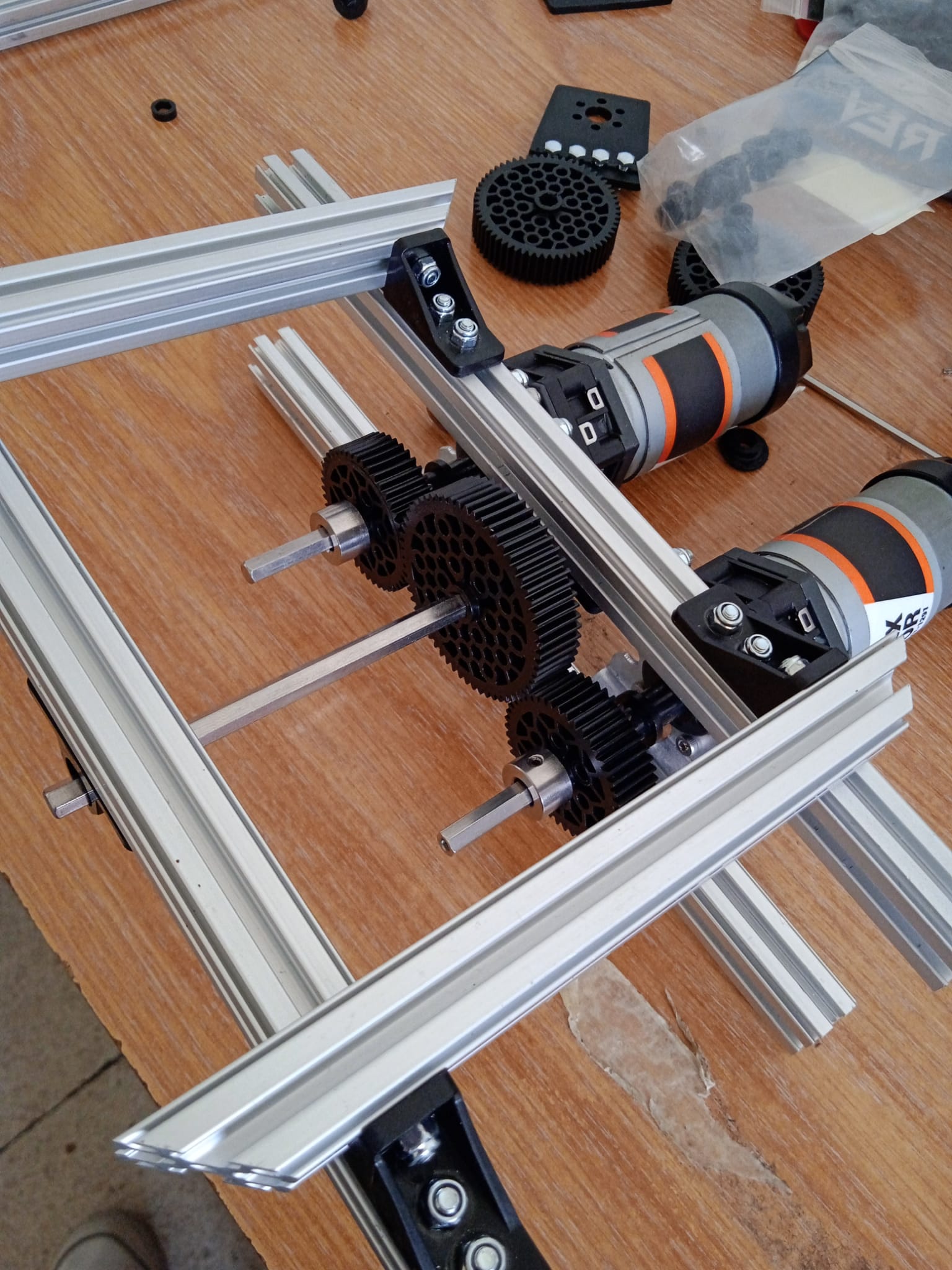

Sorry for my late reply. I did tried both the ratios but didn’t succeed . Now I’m trying to experiment by making a winch by itself and I’m trying two motors spinning the same shaft as I’m attaching the picture below. I put two 4:1 ratios on the motors and 1 45 tooth gear in the middle and a 30 tooth gear on the motors but still I cannot lift the 22lbs.
The winch drum looks much larger than the 3/4 inch diameter you described earlier in the post. This change increases the torque required to lift your 22lbs, which is probably why you can’t lift it now. Try decreasing the diameter of the drum.

Adding a second motor doubles your power, but you still need your gear ratios to be higher - with two motors and the numbers above, you might be able to get by with 35:1 gear ratios on them, but you’re nowhere near that with what you described.

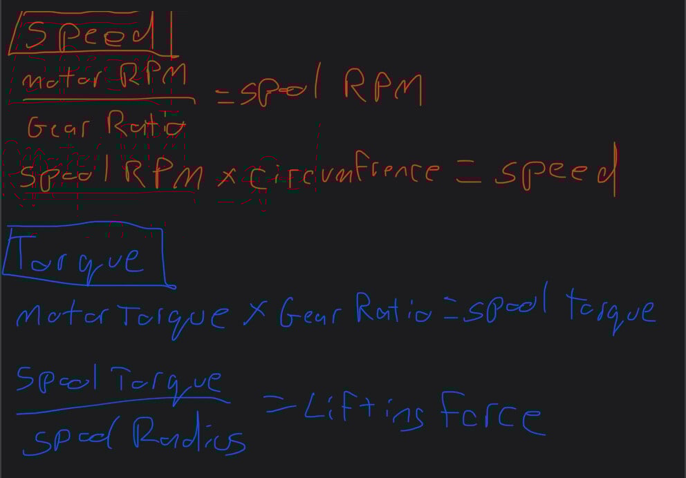

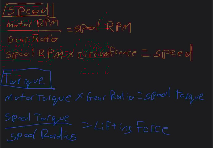

Your basic equations are:
The two red equations could be written as a single equation easily enough, but breaking it out this way helps show what each part of the equation is actually doing. Ditto for the blue!
The motor specs we have are 6000 RPM and 1 in * lbs of torque - those are the starting points for the red and blue equations (for a single motor… if you have two motors, then you double the torque while the speed remains constant)!
Your requirements are 22 lbs, 10 seconds, and 67 inches of travel - those are the lifting force and speed, or the ending points for your equations.
In the middle you have your gear ratio and your spool dimensions. You can’t solve for one without knowing the other. Sometimes, you have a spool in mind, so you plug in the numbers from your spool to figure out your ratio. Other times, you may have limited ratios available, so you plug those in to see what spool sizes you can use.
Try playing with those equations a little, along with your available gear ratios and spools, and see what you can learn!
Try plugging in your current spool diameter of 8 inches to see what you get. Then plug in a spool diameter of 4 inches, then 2 inches, then 1 inch, then 1/2 inch to see what you get in each case and compare the results.
