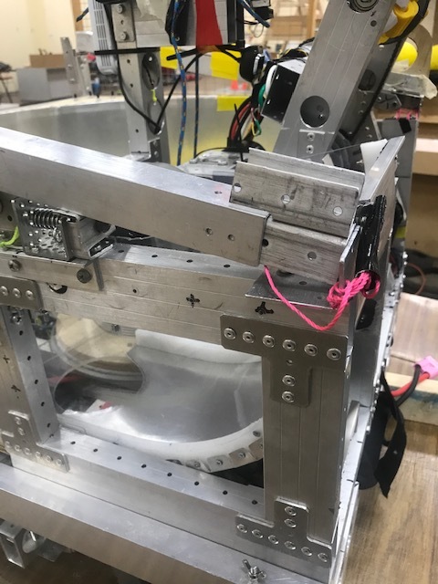

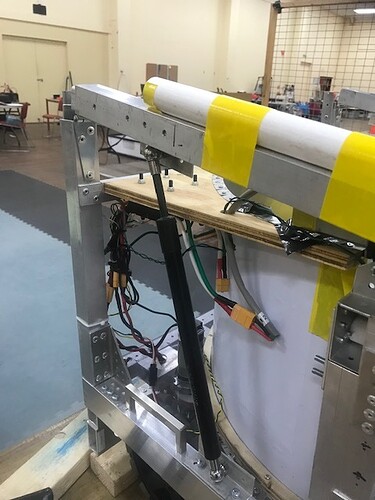

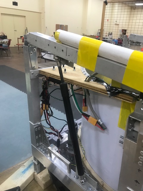

It may not be much use for you now, but here’s the pictures of what we did.
There’s a short video of it in action (it was taken quickly, so I released it by hand as the robot wasn’t enabled) just showing the mechanism.
I think we made it in an afternoon - there isn’t much to it, it folds down nicely, and can bend back without any problem.

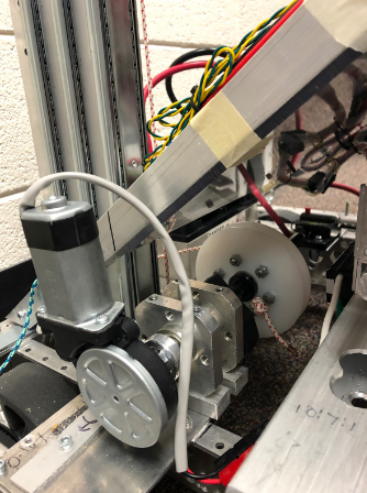

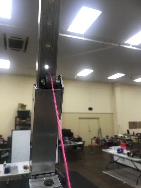

To pull up the drawer slides, we winch up the rope that is on the pulleys on the drawer slides which then pulls all the stages of the climber up the the desired height. The rope then wraps on the white wheel that can be seen in the image below.
ClimberWheel
