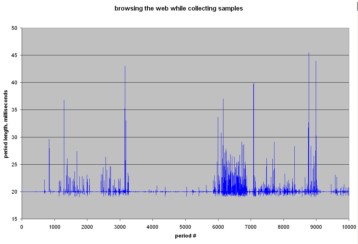

I don’t have a digital storage scope either, but here’s a graph showing the timing jitter of 10,000 samples I just collected of a 20ms period task running on an XP machine.
Looks pretty good, but 10,000 samples at 50Hz is only 3.3 minutes, and I didn’t have anything else running.
I’ll post more detail later tomorrow how I acquired the data if there’s interest.
See attached graph of samples collected while surfing the web. Yikes!

Keep in mind that the data I generated was from a small app I wrote in which I made no attempt to optimize the realtime behavior. I don’t know what steps were taken in the Driver Station app to make its realtime behavior more stable and accurate.
To collect the data shown in my previous two posts, I wrote a simple 32-bit Windows console app (different from this) which allowed me to run a test and grab the data all on one machine. It basically does this (pseudo-code):
first collect the samples:
samples=10000;
for(i=0,i<=samples,i++){
sleep(20);
// grab RDTSC1 here
then write them to a file:
for(i=1,i<=samples,i++){
// write i and (sample*-sample*) to the output file
So basically, I am sampling the time at each start of a 20ms periodic task. The difference in start times between consecutive periods is what I plotted.
To plot the data:
  • import the data into Excel
  • plot the data and locate the “quiescent” value
  • go back and multiply each data point by 20/quiescent
  • re-plot the data

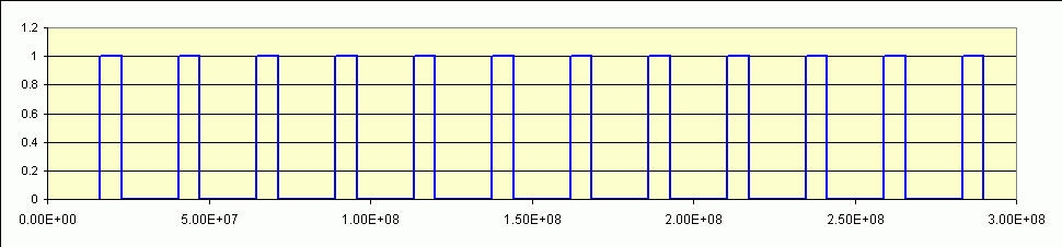

OK I did it:
XP machine running a process which toggles the COM1 RTS pin at 50Hz 25% duty cycle (5ms ON, 15ms OFF).
Null modem cable connects the COM1 port of the XP machine to COM1 of a Gateway 9550 laptop booted to FreeDOS and running an app which timestamps***** the rising and falling edges of the signal on its COM1 CTS pin.
Attached is a plot of a portion of the data.
*with a 1.13 GHz counter
50Hz 25% duty data.txt (5.27 KB)
