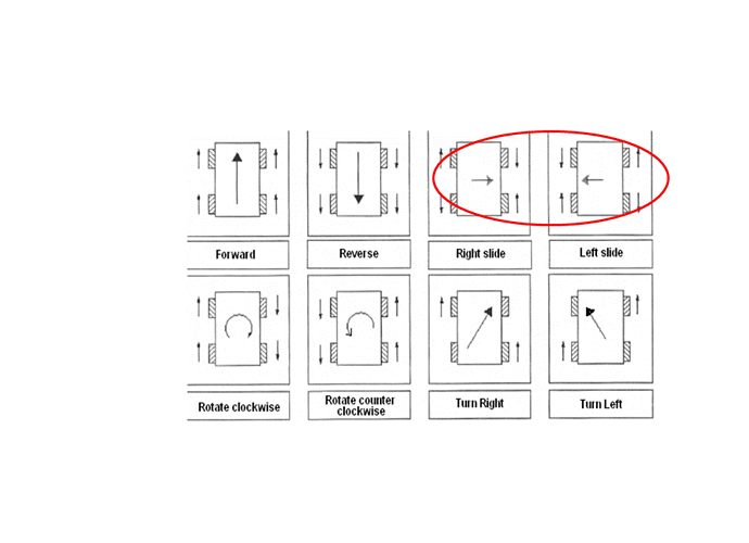

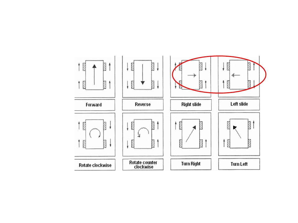

we are trying to write a code on windriver /C++ for mecanum wheels but tell now we haven’t succeed to use the HolonomicDrive function and open declaration for it from MyRobot.cpp !!
any suggestion on how to find the declaration for the HolonomicDrive functionand how to use it?
we also tried to upload our prier code which written by EasyCPro 2008 into windriver
any suggestion or advices on how we can use our EsayCPro code in Windirver ,
