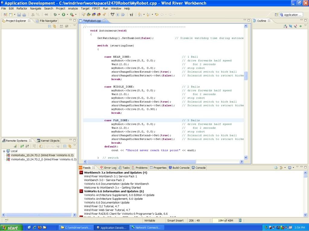

Why don’t you post a screen shot showing the project explorer?
Wyrm Dothen uploaded this image to
Here, i think i uploaded it right. there is absolutely nothing in the project explorer.

Edit: I can see from your screenshot that you do have a c:\windriver\workspace directory.
