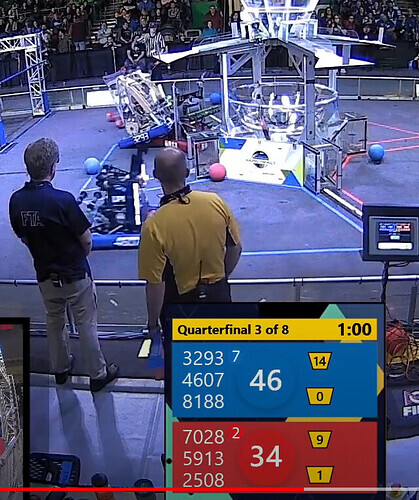

In this sequence of matches, the 2 seed with 5913, 7028, and 2508 played the 7 seed with 4607, 3293, and 8188. 5913 was putting up 10+ Cargo in teleop with a sub 15 second Traversal, and is one of the best teams in MN. 7028 was putting up similar Cargo numbers with a fast Mid Climb and is also one of the best teams in MN (this event was stacked). 2508 had a solid ~40 second Traversal Climb. 4607 was averaging around 8 Cargo per match throughout the tournament, but averaged over 12 Cargo per match over their last 4 matches with a 15 second Traversal. 3293 was averaging 5 Cargo per match and had a ~50 second Traversal Climb, 8188 played lights out defense with an unproven Traversal climber and 2 ball auto that they finally got working right after quals ended.
QF Match 1:
2 Seed Auto+Climbs: 49 points
2 Seed Teleop: 20 points
7 Seed Auto+Climbs: 51 Points
7 Seed Teleop: 28 points
Tale of the Tape:
Summary
The strategy going into this match was for 3293 to play defense on 5913, and 8188 to play defense on 7028. 7028 had 7 High goals and 5913 had 2 + 2 low goals, but I understand their shooter was damaged part way through the match due to contact inside frame perimeter that wasn’t called. 2508 had a Roborio reboot which took them out of commission defending 4607 for about 30 seconds and allowed them to put up 14 Cargo. The margins were tight but the 7 Seed pulled this one out by 10 points.
QF Match 2:
2 Seed Auto+Climbs: 54 points
2 Seed Teleop: 26 points
7 Seed Auto+Climbs: 38 Points
7 Seed Teleop: 24 points
Tale of the Tape:
Summary
7 Seed ran with the same strategy this round… with less effectiveness now that the 2 Seed was fully functional. The 7 seed also had much worse auto luck this round with only 3 made instead of 6. 7028 made 5 Cargo before their shooter broke and 5913 made 8 under heavy defense. 4607 regressed a bit under heavier defense and scored 12 Cargo in teleop.
QF Match 3:
2 Seed Auto+Climbs: 47 points
2 Seed Teleop: 16 points
7 Seed Auto+Climbs: 57 Points
7 Seed Teleop: 22 points
Tape of the Tape:
Summary
A much better auto performance gave the 7 Seed a 32-22 lead out of auto. 7028’s shooter was broken going into this match but that wasn’t known by the 7 seed until well into the match. The 2 seed changed strategies to have 7028 play defense on 4607, and 2508 played counter defense on 3293. 8188 played counter defense on 7028… so it ultimately came down to a 1v1 with 4607 and 5913 as the only viable scorers.
