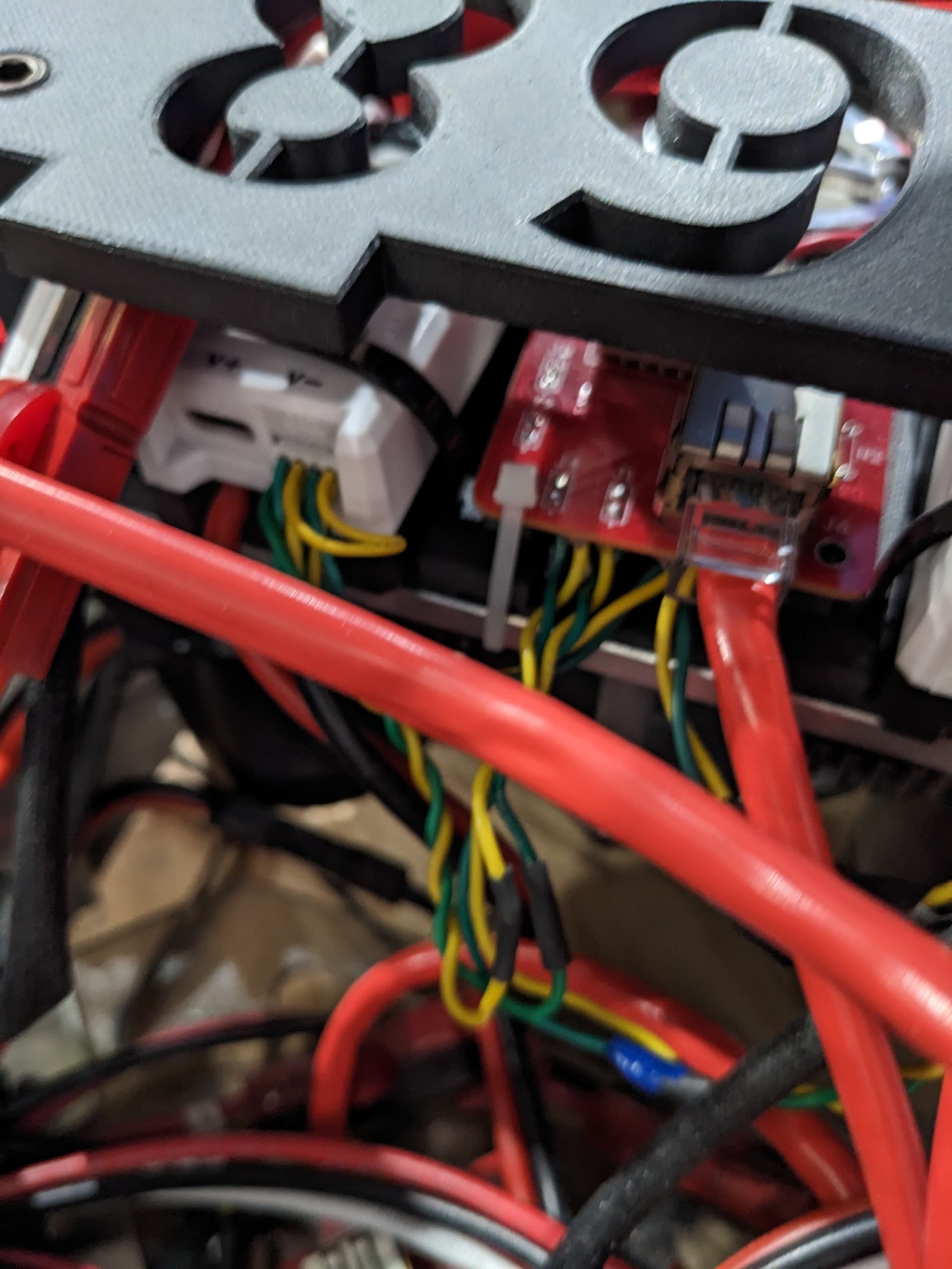

hi, we’re looking for alternatives to molex connectors for signal wire splicing. I’ve read here that wago 221 (squarish transparent ones with orange levers) can damage fine stranded wires. are 222 (gray curvy levers) any better? has anyone used wago 873 (luminaire disconnects) or 243 (micro push wire)? any other good options?

thanks all, i do like the wagos and the little levers, and i’m encouraged by the thought about strain relief. one other idea, an example from 668, they made little interface boards for their canbus wiring so they could use ethernet cabling.
We have switched to Deutsch connectors for our CAN bus and have not had a failure since switching. They are more expensive, and take longer to initially set up, but they are rock solid.
