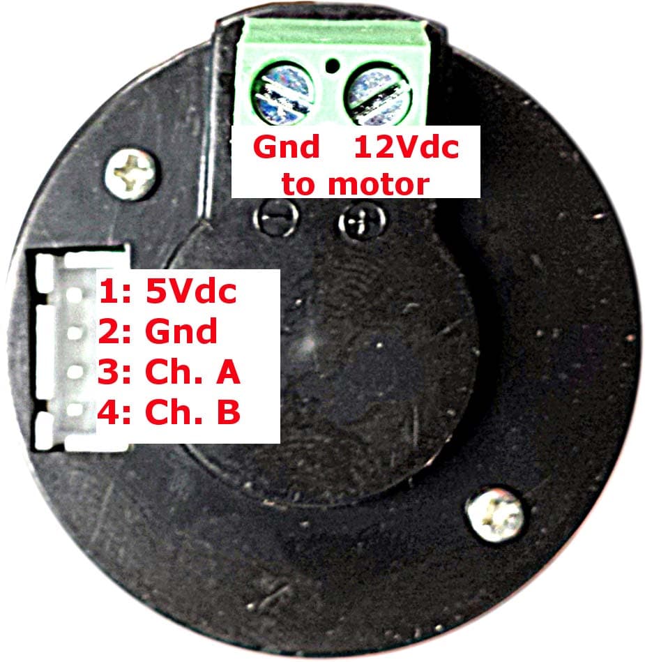

Our team has been trying to figure out how to wire the am-3009 swerve drive from andy mark and have been having some trouble figuring out just how to properly wire it. We have the neo drive and have also had no luck finding any reference online. Is there any where else to look or any advise for how exactly to wire this.
It’s fairly standard. The Neo motor will connect to a Spark MAX, and the PG motor will connect to the motor controller of your choice.

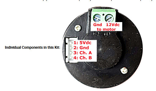

The PG motor has an encoder on it. That can either wire into your RIO, or potentially your motor controller (depending on your choice of motor controllers). You can find some documentation on doing this here, but this is a pretty standard quad encoder.
You may have also gotten an absolute encoder. This CAN replace the PG encoder if you wanted to. The interface will depending on your chosen motor controller.

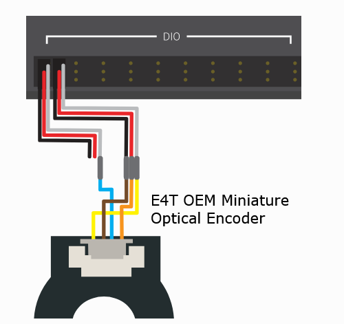

Hey, i know this is a little overdue, but we saw your message and forgot to respond. We postponed doing swerve until now like you suggested. I wanted to ask you how you would wire it to the Rio, like what wires to what pinouts?
Here is your pinout:
Wires in kind of like this to the DIO port. You’ll need 2 ports for each encoder.
If you look at your rio, the pins are labeled. Ground will go to ground on the encoder. 5V goes to the 5V on your encoder. Channel A goes to one of the signal pins. Channel B goes to the signal pins on the 2nd port you use. You only need 1 wire on the 2nd port.

Our team has been trying to figure out how to wire the am-3009 swerve drive from andy mark and have been having some trouble figuring out just how to properly wire it. I wanted to ask how you would wire the PG motor to the Rio, like what wires to what pinouts?
The green screw terminal block will go to a motor controller. The encoder wires will go to two Digital I/O ports on the RoboRio. 5V/Signal/Ground should be labeled on the RoboRIo itself.

I apologize for the separation of my replies and my ineptitude. However, suppose we must wire it to the RIO; otherwise, there is a 0% chance of us being able to practice or use swerve drive this upcoming year. How would the code for that work? Our current setup consists of Spark MAX’s controlling the Neos on the swerve, and Victor SPX running as power on the PG motors, with the encoders wired directly to the RIO. If I am doing anything incorrectly in this setup, please assist me.
That sounds correct. You just need to make an Encoder object in your code and specify the pins.
