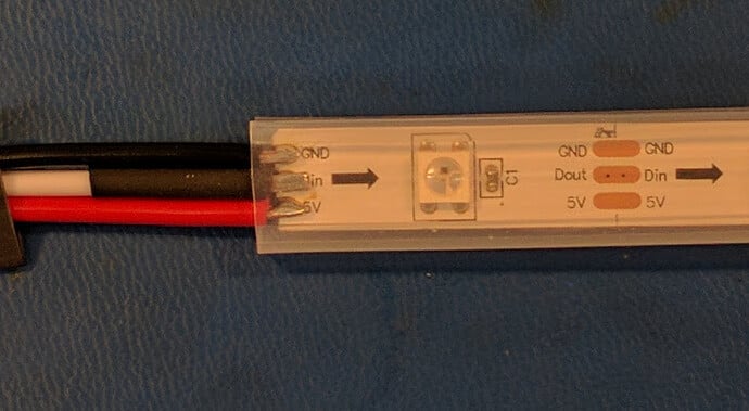

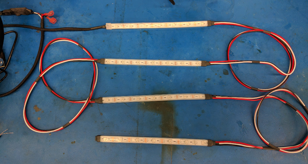

I constructed a similar Neopixel RGB LED light assembly controlled by an Arduino compatible controller. It is very similar to the AM-3010 kit they sell at AndyMark. I bought my parts from Adafruit, and used their Neopixel Uberguide to connect them.

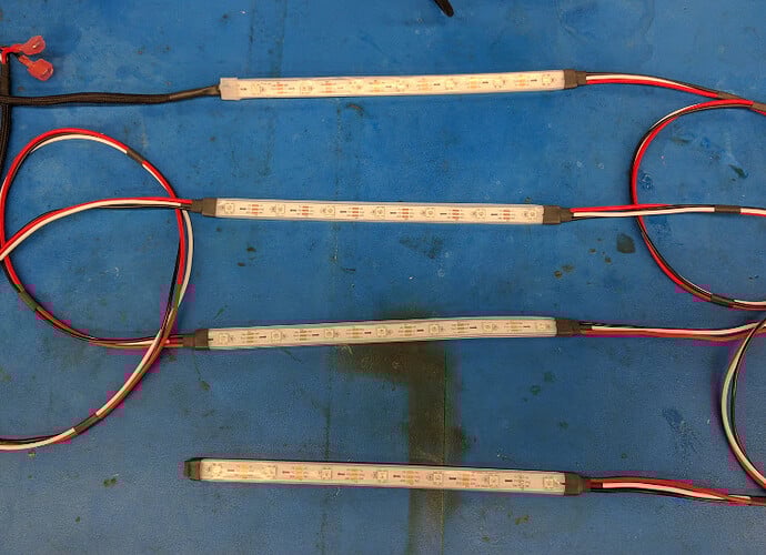

We wanted 4 short strings of 7 LEDs on each of the four corners of the robot. This was accomplished using a single 30 LED RGB Neopixel strand https://www.adafruit.com/products/1376 , cut into 4 sections of 7 LEDs with extension wire in between. I used a Teensy 3.2 (Arduino compatible) to control it with a single signal wire. Further, I did not need an additional power supply, since the current drain can be controlled by varying the brightness & color. I am strobing the LEDs and colors so that the current drain is less than 300ma total. This is easily powered by any garden-variety USB port, and allows quick software testing using just a laptop alone.

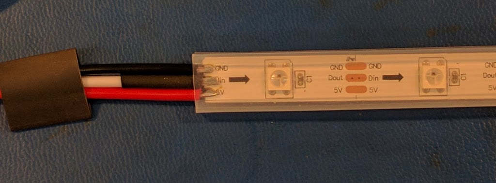

With that as background, I noticed some things during the assembly that could cause your shorting issues. When you cut the strand, you are also cutting through the flex circuit containing 5V / Ground / and the clear rectangular silicone insulating sleeve (with solder pads exposed at the end on the top and bottom of the flex circuit). Therefore you must insulate the connections! I slid a small piece of heatshrink over the middle signal wire, covered the solder joints with RTV silicone (not shown in the first photo), and then covered the ends with large heatshrink.
I attached an in-process photo, and a picture of the near final version 1 prototype. The photo does not show much of the Teensy 3.2, since it is enclosed in very large heatshrink. The version 1 prototype shown includes external 5V/GND power connection capability that is no longer needed.
