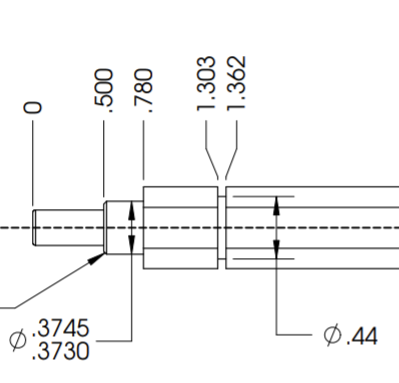

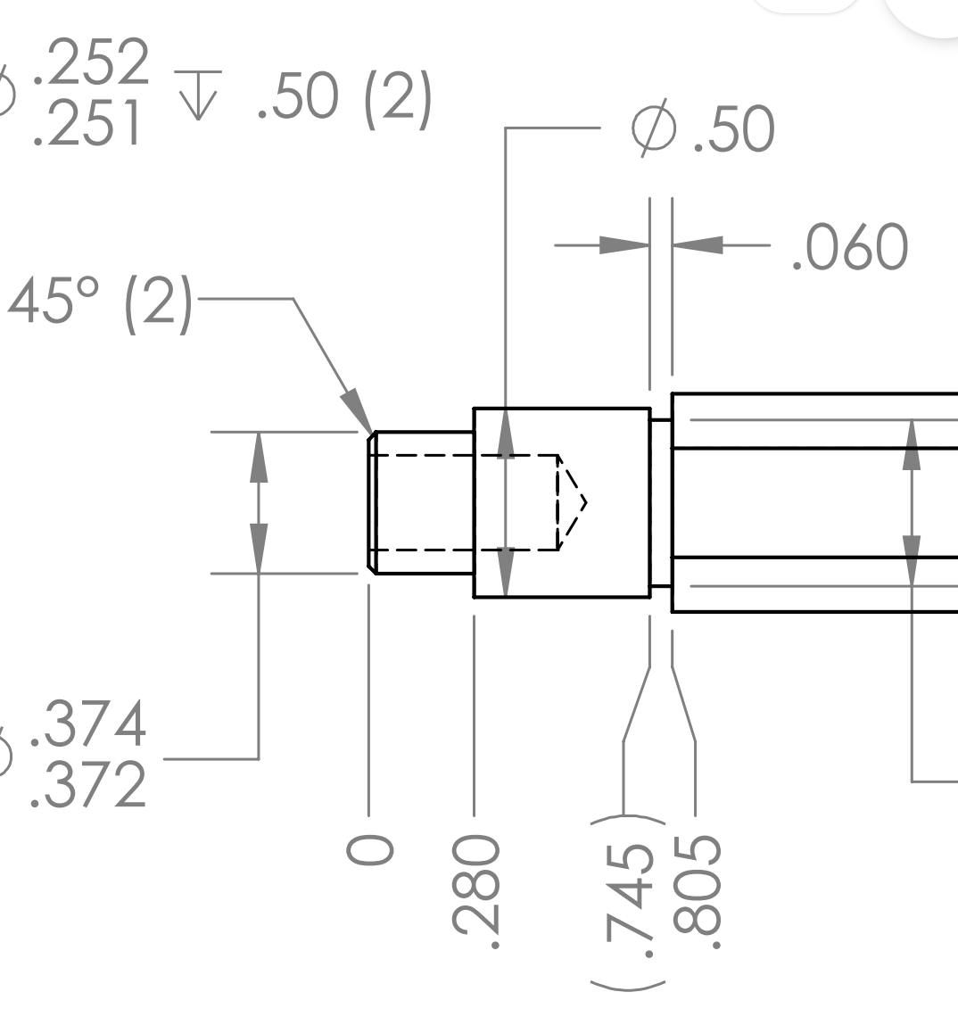

Older shafts do not appear to be compatible with the new gearboxes on this year’s KOP chassis. The E clip groove is 0.057in closer to the bearing face on the 2023 shaft vs older ones. So if you want to swap them out you will need an old gear set as well, which could cause some problems as the 23KOP Chassis also has a different gear ratio as prior years.

Anyone know the difference in KoP gearbox gear ratios from last year to this year? We still have our 2022 kitbot toughboxes.
Last year: 10.71:1.
This year: 8.45:1.
We’re using the 2023 gearboxes and wanted to use the 8.45:1, but we did NOT use the 2022 gearboxes from the kit. So, we had unused 2022 drive shafts.
We just lathed the e-clip slot to be further back. Its wider now but the gears push the clip against the new limit. It is in the process of testing, but it seems like a “sort of” solution.
