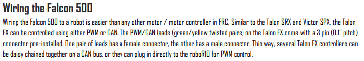

This isn’t correct. All FRC legal motor controllers, including the one built into the Falcon, can be controlled over PWM. You don’t get all of the “smart” features that make the Falcon worth the cost, but you can control it in standard %VBus mode.
From the Falcon user guide:
