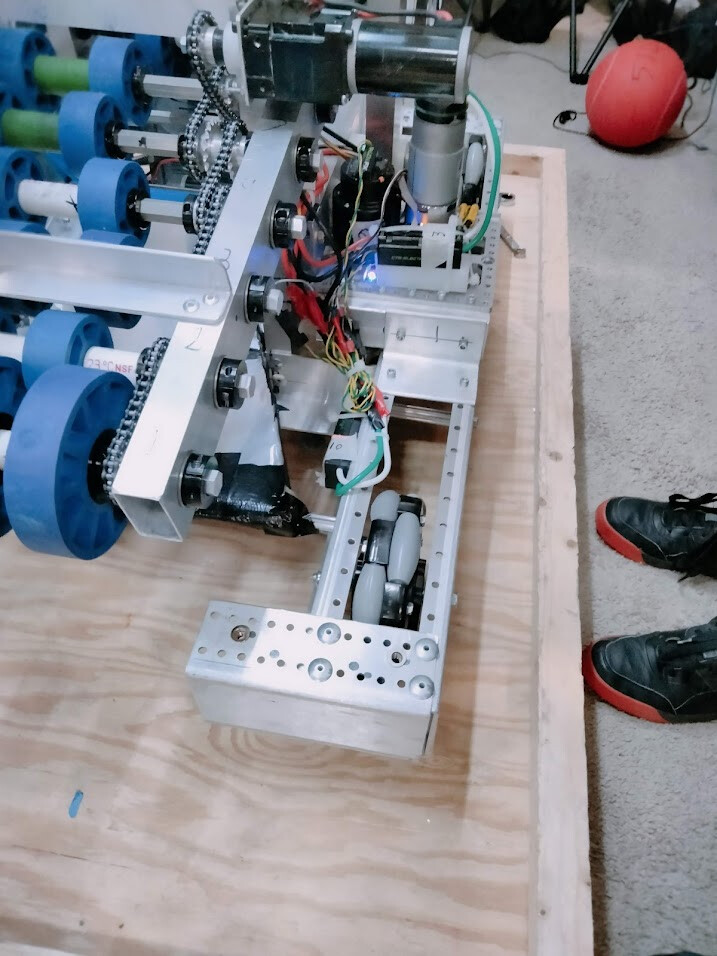

Hey y’all, we’re definitely interested in swerve for the future seasons, here’s a picture of our current robot using a KoP drivetrain (AM14U5). Hoping we can step it up in the off-season with some cool things!
(Full disclaimer: we are aware of the many challenges that swerve presents, we thought the 1 wheel swerve was an innovative idea that could come up with some awesome movements. We have designs for a WCD, however we did not feel that the attempt to make one over the kitbot would be worth it…glad we made that decision)
