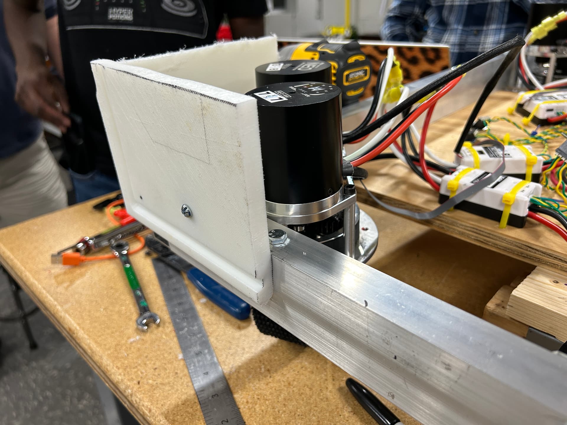

Would this be considered part of a frame perimeter?
My team is playing around with HDPE to see if we might ever use the material for robot parts. Meanwhile we’re prototyping a swerve chassis, and are concerned about the motors taking a hit. So we used the old cutting board to make a rough concept to protect the corners. The discussion came up about whether the HDPE would be considered part of the perimeter (assuming constructed and fastened much better than in the photo) or it would be considered something not a part of the perimeter. The perimeter definition is: fixed, non-articulated structural elements of the ROBOT contained within the BUMPER ZONE.
What do you think - would something like this pass inspection or not, assuming the bumpers were constructed so it was inside the bumper zone?
Definitely, 100%. I believe that we have used a plastic le that in 2022 when our bumpers when out if square.
100% that’s part of the Frame Perimeter. It doesn’t fit the Minor Protrusion exception.

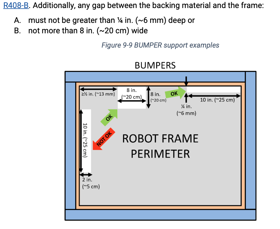

I would consider the HDPE as defining the frame perimeter. As to passing inspection, I don’t have enough information. It appears to me that the HDPE is thicker than 1/4" so my first question would be is the portion not protected by the HDPE longer than 8" (see rule R410 and the red arrow below):
If so then you can’t have bumpers across that region w/o adding support for them. If you are just doing corner bumpers, as long as they and the HDPE are at least 6" across, that would also work.
Thank you all. Most likely if we created a “cage” to protect our motors it would be from 1/8 or 1/4" aluminum, and mounted to the top of the 1x 2, and not HDPE, although we like the increased impact resistance of the HDPE. And instead of using an old, discarded cutting board we would purchase HDPE stock from somewhere. If we did something like in the photo we would definitely have any gaps >8" filled with the hdpe or something else.
We mainly had a question about whether something like that would be part of the frame or not.

As others have stated, your HDPE panels, as shown, will be defining your frame perimeter and it appears likely that there will be a greater than 8" between the HDPE panels at each corner, making the bumper mounting illegal.
It would be best to use more than one screw to attach each HDPE panel to your chassis. It would also be best to use a piece of aluminum angle to attach the two HDPE panels to each other so that they brace each other against impacts. Adding a third panel on top would make it very solid and prevent the panels from being caught on parts of other people’s robot that intrudes inside your frame perimeter.

This is correct that those panels likely define your frame perimeter. The easy fix is to add more HDPE or other material that’s the same or slightly smaller thickness in more places along your aluminum rails so there are no longer any gaps larger than 8’ between any two pieces.
