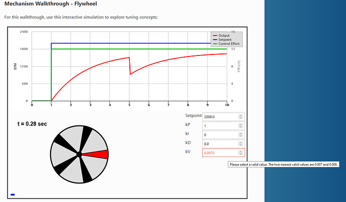

Feedback:
Trying to implement the solution for Flywheel Tuning Step 2 and setting kV to 0.0075 as recommended you get the following error.

Gotcha. I concur something is smelly here. The underlying logic is done in a mix of revolutions and radians (RPM was purely for cosmetic display). Lemme do a walkthrough of the units and make sure things are internally consistent. At a minimum, while the system is overall ‘functional’, I would expect the thing you noticed to confuse a mathematically-inclined, detail-oriented student.
Yup that shouldn’t be there, will fix.
Can do - it’s a property of the underlying modeled motor and gearing (and is a good Segway into the “actuator saturation” common issue). Lemme do some thinking on how to handle this, whether it’s a “add more words” or just cap the text box input value.

So, at least in the nomenclature established in the WPILib docs, for the flywheel,
  • “Setpoint” is the desired, commanded speed of the flywheel
  • “Output” is the actual, measured speed of the flywheel
  • “control effort” is the voltage applied to the motor
I expect that with feedforward only, the voltage should step up to a constant value, and the actual speed of the flywheel should accelerate gradually (with, largely, exponential behavior).
So, with that in mind… does that help clarify what you’re seeing? If so, I can work to make sure those ideas are presented earlier rather than later.
It’s a gamepiece being injected into the flywheel. It’s mentioned in one sentence buried in the middle of other explanation, but it’s definitely less than obvious.
Based on multiple feedback comments on this, I’m actually thinking I might just expand the animation to show a ball making contact with the wheel and flying out. Would that help?
