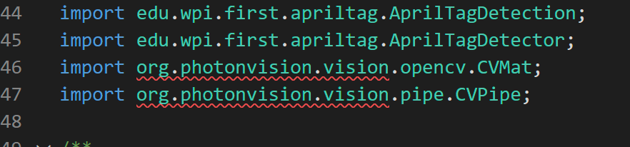

I am experimenting with running AprilTagDetector on the Rio, but the code is trying to import PhotonVision. I assume I need to install PhotonVision as a vendor lib. If so, where can I find the json for it or download the off-line package for it?
Limelight has released Limelight 3 yesterday, but older models are expected to support AprilTags too. In the meantime, you can install Photo vision on a Limelight.
I finally found the PhotonVision json file and have installed it as a vendor lib. I checked and it’s now in my vendor lib list, but I still get unresolved error.
The code linked above is literally part of the PhotonVision application, and won’t be in a vendor dep. It can serve as a reference for how to use the WPILib classes, but it’s not going to be copy and paste into robot code. Essentially the way to use the classes in a robot program thread is going to be something like (untested):

So, should I remove the PhotonVision vendor lib then?
Correct, it’s not needed for what you’re doing.
