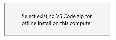

Besides, if l want to use the latest version (such as 1.64)of vscode, l can download it and install the WPILIB with it by clicking the button below. Is that right?
Edit: This method isn’t useful. l tried it just now.

As for vscode, no, the installer will only ever install a fixed version hardcoded in it. We do this, and disable automatic updates to ensure everyone is using a tested and known working configuration.
I am also unable to do the WPILib install from a downloaded ZIP file. I was able to update things by doing the online install.
I have plenty of disk space. The MD5 hash for my download matches the hash code displayed on the github release page.
Downloaded zip file? The download is a .iso (for Windows), .dmg (Mac), or .tar.gz (Linux). Can you confirm what file you downloaded?
$ md5sum WPILib_Windows64-2022.3.1.iso
8be0f176d5bf767da226c5b66d1dc944 *WPILib_Windows64-2022.3.1.iso
The WPILib install downloaded the zip file: WPILib-VSCode-1.63.2.zip
What’s the md5sum of that file? I get 0de22d001946c1795b0a415fd490fe61 *WPILib-VSCode-1.63.2.zip
