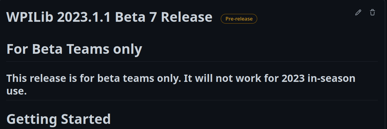

In my experience, teams don’t read, let alone remember to do things later based on what they read, but we did add that to the latest beta release page a few days ago.
The WPILib beta releases are public (right?)
It’s just the rest of the beta software (vendor deps, rio image, and game tools) that is hidden
The public WPILib beta releases make the hidden vendordeps make even less sense
