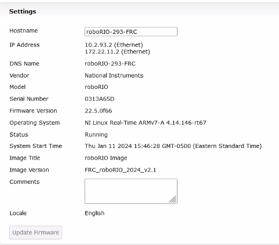

We are getting datalog writing errors and I can’t figure out why. I’m curious if we are missing a step when imaging and setting up the roboRio?
Here are the steps we took:

RoboRio info:
