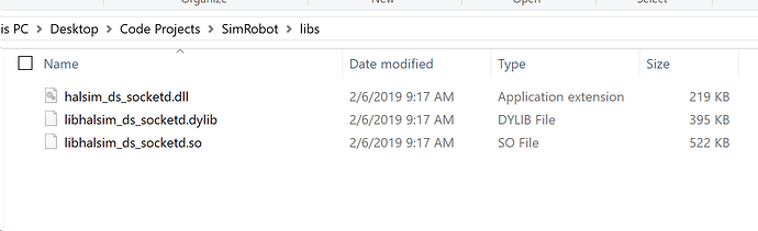

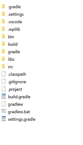

Hello, @Jaci I am trying your solution for connecting the simulation to the driver station, and the simulation runs and I see it on the Shuffleboard. However, I tried putting the 3 halsim libraries in a folder called libs in the robot directory, but the driver station still won’t connect.
https://gist.github.com/Kinzerfest/550c24c97b86b031b4822ba79abb147b
https://gist.github.com/Kinzerfest/4d973a16e634e36fbfbf6120f8dc8893
I’ve also tried setting team number to my team and also localhost.

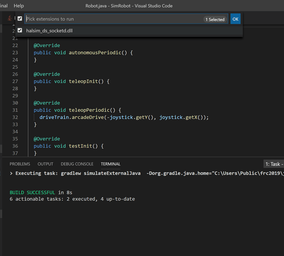

Ensure that you can see the “DriverStation Initialized” / etc text in the console log when you start the simulation. If it’s not there, delete build/debug and try launching from VSCode, making sure you select the HALSIM dll when it prompts for extensions.

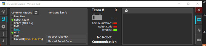

I’ve tried again, using a new project and putting the DLLS inside of it. Here are the steps that I did in a screenshot. I see networktables connected, but I don’t see anything about the driver station.
On the driver station program I try both my team number and localhost as the team number.
